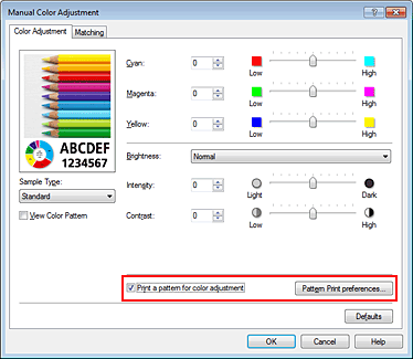

you may print pattern for color adjustment
5,148
5,039
The pattern for colour adjustment is a nice feature. Is it part of the MG5350 printer driver or a plugin from Photoshop or other program?
My newest printer is a Canon MP540, that has a similar colour adjustment, except for missing the features marked in red in the first picture. The MP540 is of the PGI-x20/CLI-x21 generation, and the MG5350 is of the newer PGI-x25/CLI-x26 generation.
The printer driver include that feature. I think is it in all series 5300
