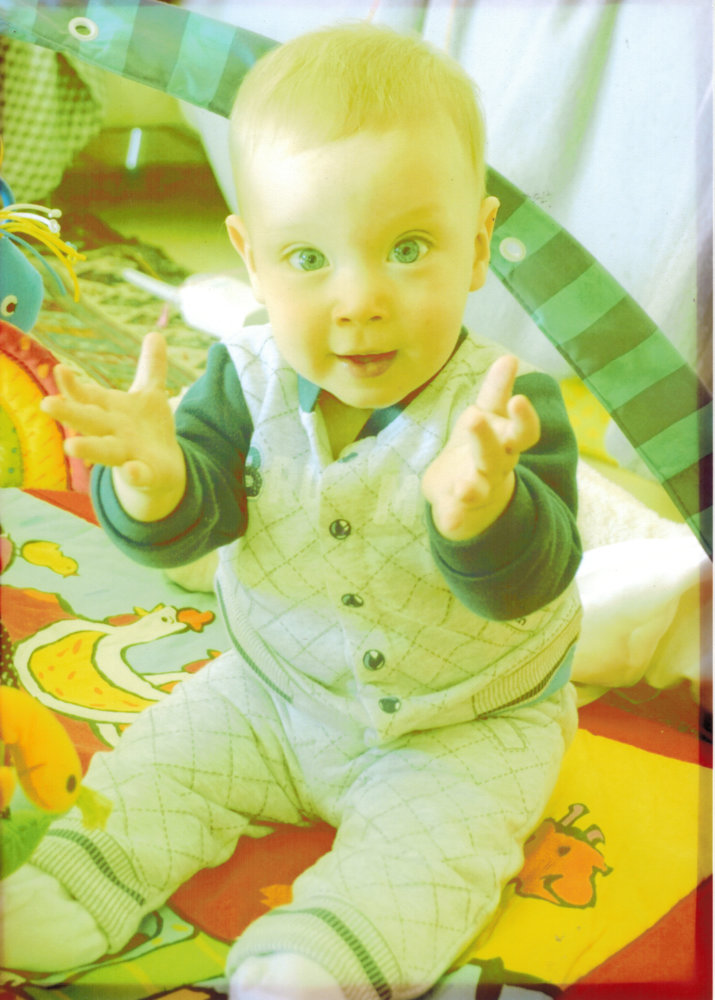

Here's a good example. PC inks on Epson ultra premium luster. It was kept in a living room that gets a lot of sun about 2 hours/day. The glass of the frame had been broken and you can see how the edges remain dark.
Since I didn't mention it before. I should add that I am somewhat galled that PC has kept his description of the EV6 inkset unchanged despite all the evidence to the contrary: "More lightfastness when primarily sunlight exposure is of concern offering significantly longer lasting prints when displayed."

You are addressing two different issues - assumed problems with cartridges or refilling in general and the fading of dye ink prints exposed to the sun.
There are various problems with refill as you are already addressing them - the ink flow is impeded one way or the other - letting air get into the ink flow, or probably not enough air into the cartridge, it can be an issue with the mechanical fit. I'm not familiar with the type of cartridges you are using so it might be difficult for some remote diagnostics.
There are quite some threads posted here with tests of the ink fading performance of various inks - mostly Epson, and I'm running as well a test at this time
https://www.printerknowledge.com/th...nks-and-alternatives.11841/page-3#post-101145
and keep in mind that the paper used has as well a significant impact onto the fading performance.
There are big differences between inks, and lots of claims about the fading performance, although there are gradual transitions between the groups I would put the inks into 3 ranges - performance equal to or similar with Epson Claria inks, Fujifilm DL, and Ultrachrome D6, a medium performing range and some inks you can watch fading when you just look to them, you don't need to go through all the details here

The EV6 inks were performing better than quite some other inks as I remember but I didn't list any of those fast fading inks because I wanted to look more to the better performing ones, there are too many of those types at the low performing range. Yes, you can use another black, the black controls the overall perception of contrast in an image. But the other inks should be equivalent or you get a shift in the color balance sooner or later. And to be accurate not all black inks are alike, they differ in their black level which controls the transition point for the black point compensation if you print with a profile activated. There is a very fine wire mesh filter in most refill cartridges close to the ink outlet so particles will be caught there .
