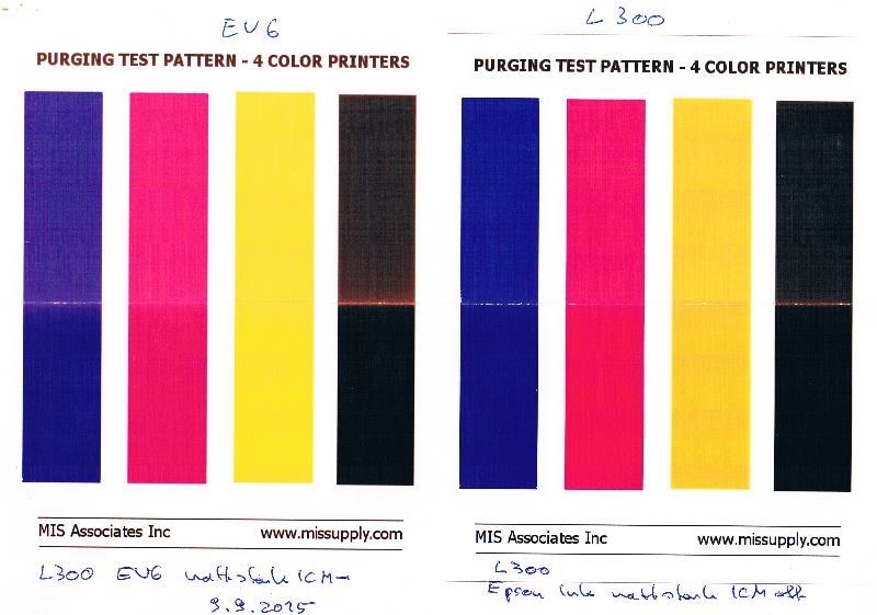

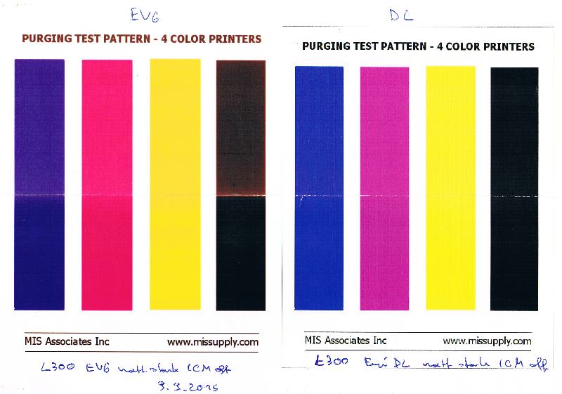

the fading goes on - it becomes more apparent after a few more days that the EV6 ink cannot compete with the Fujifilm DL ink
that's the same target sheet as above, black of the EV6 patches turns into chocolade color, and cyan fading becomes visible as well.
I had one patch sheet left with the bottled Epson ink from an L300, and I added the patches with the EV6 ink onto the same sheet
Even the L300 ink, the black performs better than the EV6 ink, although the L300 ink was not reported as a fade resistant ink by WIR, or by my earlier tests 6 months ago.
I have another patch - not uploaded - comparing EV6 to a Coralgraph ink, they fade about at the
same pace, EV6 is belongs into a group of typical inks, Coralgraph, OCP etc which are suitable for Epson, and have a good gamut, but do not excel in the fading test.
If fading is important for you/for your printouts the only inks meeting this expectation are the Fujifilm Dralab DL inks, drained from the cartridges, and the Epson Surelab Ultrachrome D6 inks.

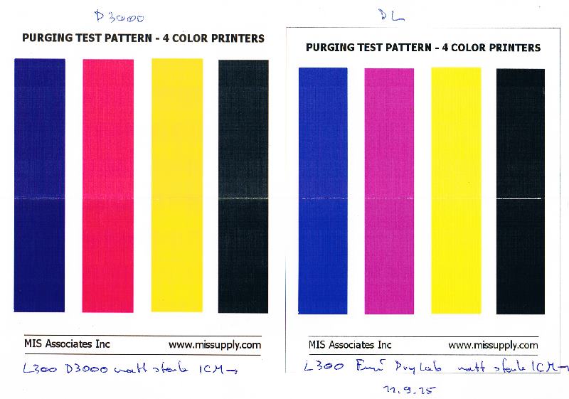

I have another comparison running with a Chinese ink claiming D3000 compatibility
This D3000 ink is so far the only ink in test staying close to the DL ink, and I'll continue the
test only with this one, the EV6 ink is out of competition. Please keep in mind, all dye inks
fade, most inks pretty quick, you can watch some turning brown in a short time, and a very few inks stay for weeks until changes become visible, and not already after a few days. And I'm not testing any other measures to prolong the fading time such as laminating, putting them behind glass, using transparent lacquers or coatings, gloss optimizers etc.
