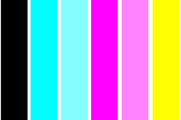

During the course of adding carts every 24 hours after the second head cleaning I was puzzled when, with only the two blacks installed along with three cleaning carts, I printed a purge print that consisted of a solid black bar on a web page...and it came out pink (the only cleaning cart that had any color left in it at this point was a previously-contaminated magenta...now full of pink Windex). Bottom line...I printed a black bar and neither of the black carts fired! Instead, it appears the software was trying to make black out of the three primary colors!
I noticed a somewhat similar phenomena when I was printing nozzle checks after the addition of each cart. The 3eBK gave what I expected...just black on the 3eBK portion of the nozzle check print. Adding the 6BK cart added the appropriate nozzle check bar, but oddly enough the numbers and letters in the column identifying the color in the adjacent nozzle check bar were all blank (except for the 3eBK). When I added the cyan, all the numbers and letters showed up in blue (except for the 3eBK, of course...it was obviously being printed by the fat black). I added the magenta and the identifiers turned purple, and adding the yellow cart made them all turn...you guessed it...black! There's also a pattern to the color progression of the little vertical bars on either side of the identifiers as the carts were added...it's different, but I think the point has been made so I won't explain it. I kept each nozzle check for my records, though.
All this was done on plain paper, of course. In the case of the black purge print on the web, if it's true that selecting plain paper for the printing medium makes the fat black do all the black printing why did it come out pink? Obviously neither black was being used. The only thing I didn't make absolutely sure of was that plain paper was selected as the printing medium when I printed that web page. My excuse for that is I've never printed on photo paper on this printer (I use the 8500 for that) so I've never selected any other medium than plain paper. I know what happens when one assumes something, but I'll go out on a limb here and assume it knew it was being fed plain paper.

On your mystery of majic black ink, all images you print suck as .jpg color bars are graphics and the printer will never use pigment black on images. To make black it uses 33 1/3% of Cyan, Magenta, and Yellow. That is subractive black. The only time you can use the "Large Pigment Black" is when you print a "TEXT" file or your force the printer to print in "Fast Black" or in Grayscale. The Dye black is used to expand the gamut of photographic prints on photo paper. Canon would not use Dye black to make real black when they can use 3 times the ink to make black.
