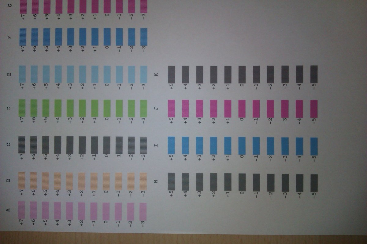

Last printer I have was canon i865 and his head is dead. When i compare same picture, the i865 win. The picture which made i9950 is I can say ill, colors are like a not alive. Then I start usually procedure, the nozzle check perfect, head alignment have one problem the column B is all away same from +7 to -3. and all away it has white vertical strikes. Is that maybe possible reason why printer have non natural colors?

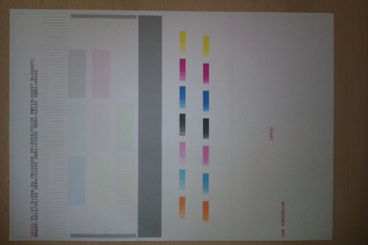

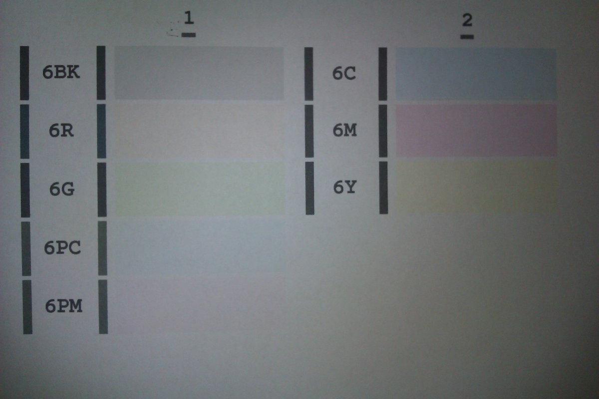

Thanks for replies,
Sorry for poor quality, but i think you can see where is the problem, on red, column B. On second picture from service mode you can see there is missing lines on red nozzle check pattern.
Is this big problem and may pictures are not good only because red alignment , I should try, as you sad, change and put canon original color inks in the printer and check for improvements?. This ones are, as I can see filling with some color from last user, I don't know anything which ink is used.

I cannot determine from your pictures if there is a print head problem. So are your pictures banded/striped or are the colours wrong. Do you have a colour cast and is a grey-scale neutral grey?

I cannot see anything seriously wrong in your pictures at all but if you want to get the printer back working perfectly again start fresh by changing the cartridges on both printers first.
There is no real point in trying to change any of your setting on the printer till you know you have a good flow of quality ink, then make your adjustments and you see the real differences.
Replace all of the compatible cartridges with OEM cartridges, you have a choice you can get brand new OEM filled carts or get empty ones (Cheaply) and fill them yourself with good quality inks, if you have difficulty getting BLI-6 carts then use CLI-8 carts instead.
When you start with all the same cartridges and inks you’ll find that both printer will produce stunning colour photos very similar to each other depending on your settings of course.

The red matrix on the service test print appears to show a repetitive loss of lines, which indicated a print head failure...

Even if I also see some striping in the red nozzle check from the service test print, I see no banding in your uploaded images so I think your print head is OK.
