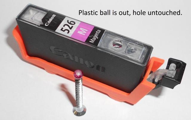

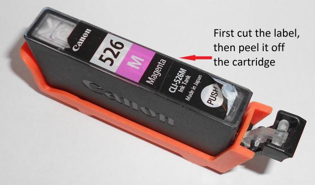

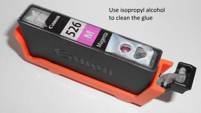

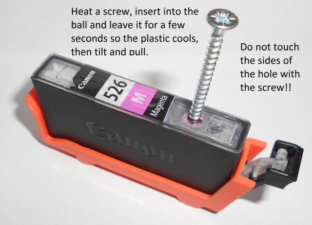

Although it is better to move the chips from 526 to 521 (525 to 520) and refill the windowed cartridges, the CLI-526 and PGI-525 can be refilled using any of the methods specific to this type of cartridge. My personal choice is the Top Filling Method.
Because my printer has a clearance problem I used a low profile plug (bought from OctoInkjet) and aluminium tape (just to be extra safe :) ). Clip and resetter also from OctoInkjet.
1. Preparing the cartridge for Top Filling:
a. <--- click to enlarge
b. <--- click to enlarge
c. <--- click to enlarge
d. <--- click to enlarge
e. <--- click to enlarge

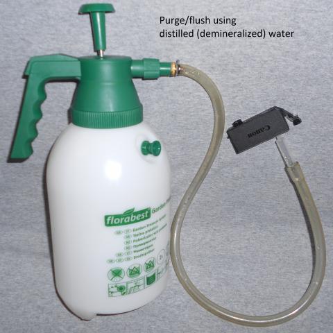

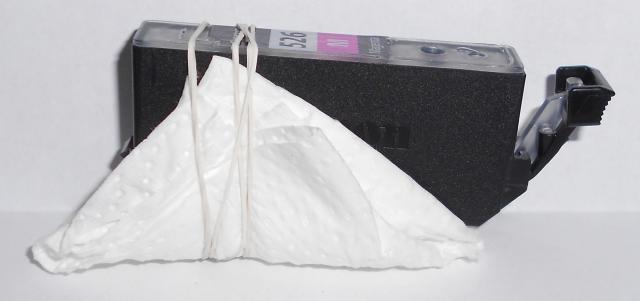

2. Purging and drying (if needed):
http://www.nifty-stuff.com/forum/viewtopic.php?id=5382

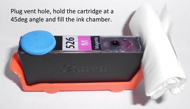

3. Refilling:

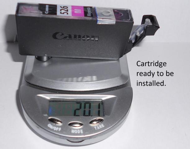

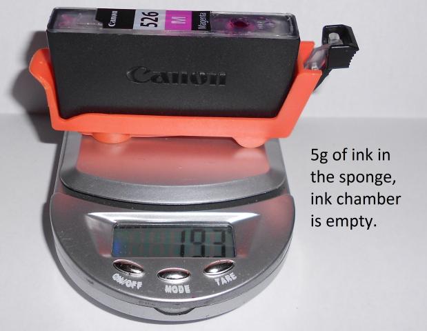

A cartridge with enough ink in the sponge and empty ink chamber weighs 15,8g (without clip). Measure the weight of the cartridge you want to refill ( x grams). In this step you will need to fill with 15,8-x ml of ink and let the cartridge sit for 1-2 minutes.
Here's an Excel calculator, if you use syringes: http://rapidshare.com/files/967513830/Refill calculator.xls . All you have to do is input the weight of the cartridge to be refilled in the "Initial weight without clip" column and you get the amount of ink needed for the sponge.
Cartridge weight before refill (label off, ball removed, flushed, dryed) - 10,8 g
Cartridge weight after refill (with plug and aluminium tape) - 20,1 g
15,915
8,923

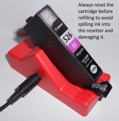

One thing dough can you edit your thread to include the resetting of the chip before commencing the refill procedure..
Tudor
May 6, 2011
505
203
Cluj-Napoca, Romania
Epson L800, 1400; ML-2165W
If you mean pictures... that ship has sailed. :) It is mentioned in the post, though.
I'll look later to see if I find another untouched 526M and include pictures of the reset. Maybe some with the purge and drying. Thanks for the input!
Ok, done!

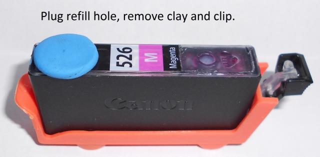

May I suggest one small edit? In the last picture I think the text should be:"Remove the clay, the clip and install" When inserting the plug with the vent covered, a small positive pressure might be created inside the cartridge. Removing the clay before removing the clip releases this possible pressure and minimizes the risk of the cartridge spilling a drop or two of ink when removing the clip.

I flushed, dried and refilled a set using the top fill method and noticed that the cartridges were underfilled. Probably because they were too dry. The method, as presented above, is not complete and it will need some more tweaking.
By using a scale and repeatedly filling the cartridges I got them to 20.5 gr, which is more than ok for top filling.
Maybe using syringes is a better idea. With squeeze bottles you have no idea how much ink you inject.
L.E. The first post was modified since.
The pigment black PGI-525 refused to take ink when dry so I overfilled it using "the freedom method" and got it to 35 gr. I expect that on next refill I will be able to use top fill with this one.

@lin:
The idea was to not overfill the sponge. If you read the writing on the pictures you will find these steps:
a. Close the vent with the clay;
b. Unplug the refill hole (if plugged), fill the ink chamber and plug it;
c. Remove the clay and wait 2 minutes for the sponge to absorb as much ink as it needs. You can wait longer, but 2 minutes should be enough.
If needed you can repeat steps b and c until the cartridge reaches a weight of 20-20.5 gr.
