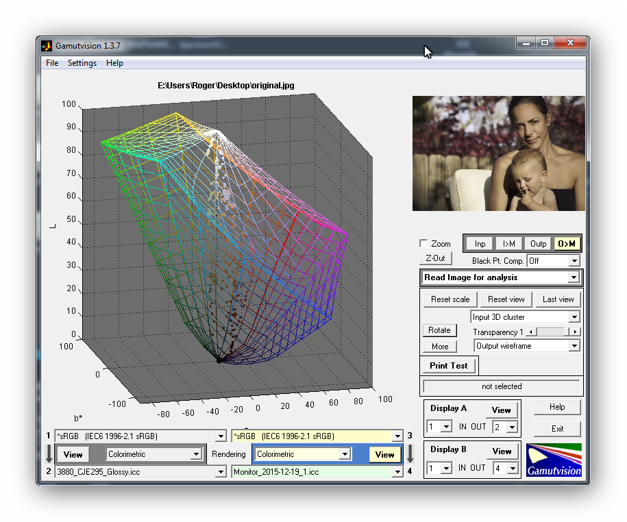

Just for interest (things are a bit quiet in the run-up to Christmas!) I downloaed your original and looked at the range of colours relative to my monitor profile. Below is how it looks. The dots represent the individual colours in your image and you can see that they are nowhere near the gamut boundaries of my monitor. I suspect your monitor is not so different.
Thank you for doing this...it is great to see that all the tones within the image fit within your display profile. I suspected this, and have done a gamut check on the image, but your plot shows this conclusively. Thanks again!
