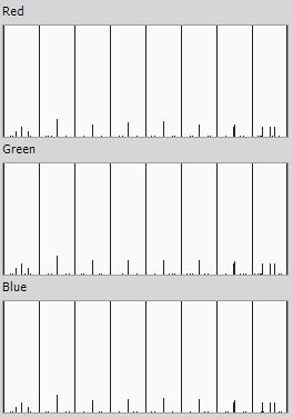

Apparently there is something positive to this process. I have a 1013 color patch tiff that I've been using to optimize the colormunki profiles. You can only optimize colormunki profiles by the way. Not others!

Jose is there any chance we could use your colour patch or can you tell us how to make one?
