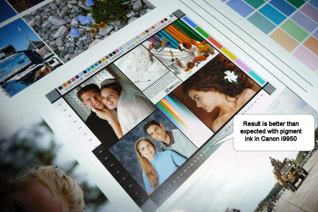

This preliminary result is quite exciting, so I started to make print on high glossy photo paper to see what the result will be, and this what I get:
The above picture is printed using a custom profile to correct for the differences due to the switch from dye to pigment ink. The result is really astonishing good for this first test.
Is everything well and good ? No: the problem I think is due to the paper, which can not absorb the ink well, causing easy rub off:
Since the paper setting of Glossy Photo Paper Extra is also using the red and green inks, which is emerged onto the surface after I use a pencil eraser to rub off the pigment ink.
This particular problem has to be tackled to get satisfactory results. Printing is good, but the ink does not adhere well on this microporous paper, which is quite annoying.
As you can see on the above pictre: the ink/paper combination is far from satisfactory.
Here are some pictures I made from the sheets printed with the pigment ink cartridges installed in my Canon i9950 and see for yourself:
The results are far better than expected and strengthen my believe the Canon i9950 is capable to handle pigment ink well and in fact is using the same printhead design as the Canon Pro 9500 (can someone confirm this ?). The above picture how good actually the printing is.

Just did a test again:
One thing: the printer was inactive for 2 days and I did the prints immediately without checking if the printhead was clogged or not. Fortunately the prints were 100 % OK so this also gives me an indication that the pigment ink did not dry up inside the nozzles.
So now I have taken a picture with my camera, to show you the actual rubbing off of the ink from the paper:
The first picture shows you the same picture on the same piece of paper, but the with different paper settings and different profiles (or lack of specific printer profile in the lower part of the picture). The upper part is done with the "Glossy Photo Paper Extra" in High Quality setting forcing the 8-colour printing modus (including the red and green inks). The lower -the off coloured version- is with the "Other Photo Paper" which used the classical 6-colour CcMmYK printing modues omitting the red and green colours.
Now see the next two pictures when I vigorously rubbed off the pigment ink from the paper and see for yourself.....
Now I hope did convince you all: the test is not fake.

pharmacist, I believe you understood me when I mentioned "gentle rub test" is use your fingers/thumbs to "gentle rub" or rather the action of gently brushing/stroke the printout. Just like when one accidentally drop their photo on the floor and after picking up the paper, using fingers/hands brushing/stroking off any dust or debris that might have gotten to the surface of the paper. Why the "gentle rub test" is because some pigment ink have adhesion problem on the photo paper such that when the photos were held, their fingers end up picking up the pigment particles. I suppose the reason you use "Eraser" is because you wanted to show the dye beneath the pigment. Otherwise, using "Eraser" is abit too extreme.

There you have your answer. Just as I had preliminary thought. I don'think it's so much as to your microporous photo paper that is causing the ink adhesion problem.
The postives note is that there is no clog issue with the ink. As it's very important for ink manufacturer to take care of clog and Kogation issue.
