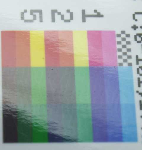

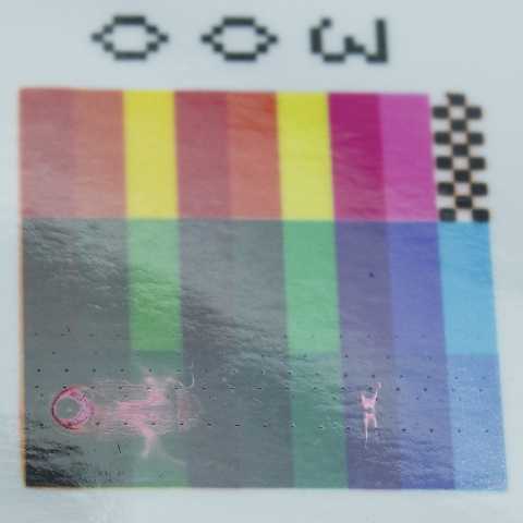

I have been exploring PrintFab and its capability to set maximum ink volume levels when a profile is created for a given printer/paper/ink combination.
When experimenting with A4 Sihl 280g glossy on the Canon Pixma Pro9000II with IS dye inks, I printed an ink level assessment test strip in PrintFab and found ink pooling/bronzing (for want of a better word), on all levels above 125 i.e. 150 to 300.
The images (click to enlarge) were difficult to produce as it required slant light illumination very carefully adjusted to show the pooling.
Looking at the enlarged 300 image, I notice that the paper has a pattern of perforations across areas of its surface. This I think is due to the printer paper feed mechanism.
It would be interesting if a pigment printer was subjected to the same test.
I have edited the post to include two additional sections of the printed test strip to give a more complete picture of the process.

Checking the Sihl website I noticed that the glossy 280 gsm paper is rated "Excellent" for a printer like the iP5200 using the Chroma Life inkset, but only "Good" for a printer like the Canon PIXMA Pro 9000 using the Lucia inkset (?). Both printers use the CLI-8 dye inks, so the inksets should be the same (?). Link here: http://www.sihl.ch/content/Products.aspx?Nid=34&Aid=661&ID=122&ArID=7&GrpID=18&CatID=45&FamID=191 , I also think the IS inkset is the same for the two printers with the exception of fewer inks for the iP5200.
Also note the difference in recommended settings: http://www.sihl.ch/download/product/e/Printer_Settings_Photo_UltimatePhotoPaper.pdf . For the Pro 9000 it is recommended to reduce the amount of ink laid down on the paper.
The Sihl links may not work, the link addresses seem to change, but then you can find them here: http://www.sihl.ch/content/default.aspx ->English->Home and Office->Photo Papers, under "Home and office media inkjet"->Quick dry photo paper 280, here is the printer compatibility list->glossy 0769 280 g/m, click the PDF icon for recommended printer settings.

Thanks for the links Peter, I have read through them. Strange that use with the 9000 is rated lower.
The "description and use" is interesting and confirms my feelings about drying time, the ColorMunki 10 minutes may be enough for profiling, but water will be coming off for some hours.

Hi, I've been using Turboprint for a couple of years now. Printfab is essentially the windows version of Turboprint (TP is for Linux). I've found that some cheaper paper will accept less ink. I have no problem setting a higher ink limit with paper like Kirkland, and I have to go lower with cheapo paper like lower end Kodak.
When you create your profile, there is an option for paper type. Instead of "Glossy Paper", try "Other Paper". You may be able to select a higher ink limit this way.
Zedonet on their support forum recommend you try different paper settings until you are able to get 225% or more. Less that that would give you a usable but not great profile - just an indication that the ink/paper/printer combo is not a perfect match

The paper settings are understandable, but what do the %age ink levels refer to, 100 to 300%, %age of what?
The test strip is a practical test and does show what an individual paper will take, irrespective of which paper settings you use.
