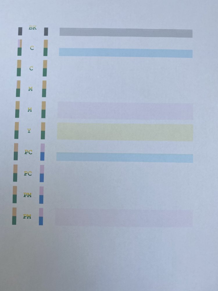

Hi,
I have a Pixma IP6600D printer and only use genuine Canon 8 ink cartridges. I've had the printer for quite a few years now with no problems.
I'm currently having issues printing (for a couple of weeks), colours are coming out wrong, images look yellow and black is really faint. So I did a couple of nozzle checks and cleans, with no change. So I assumed the print heads were clogged and removed the print head and deep cleaned it using warm water, until the water was clear, and put it back. But there's no change to the nozzle check print.
As you can see some of the colour lines are completely blank and the dark lines aren't printing at all. The black is only half printing.
Has anyone got any suggestions?
Thank you.

I am sorry to say your print head has had it, there are several large areas of the nozzles not firing due to electrical failure, and no amount of cleaning will ever bring them back. It’s time to think about getting a new printer..:(

Thank you, I suspected it might be the end of the road for the printer! At least now I can invest in a wireless one.
Thanks for your help.
