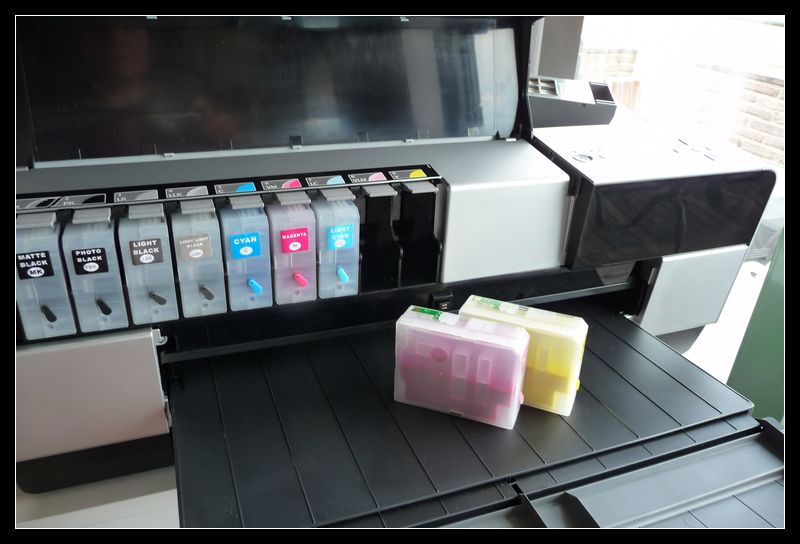

Small size cartridges:

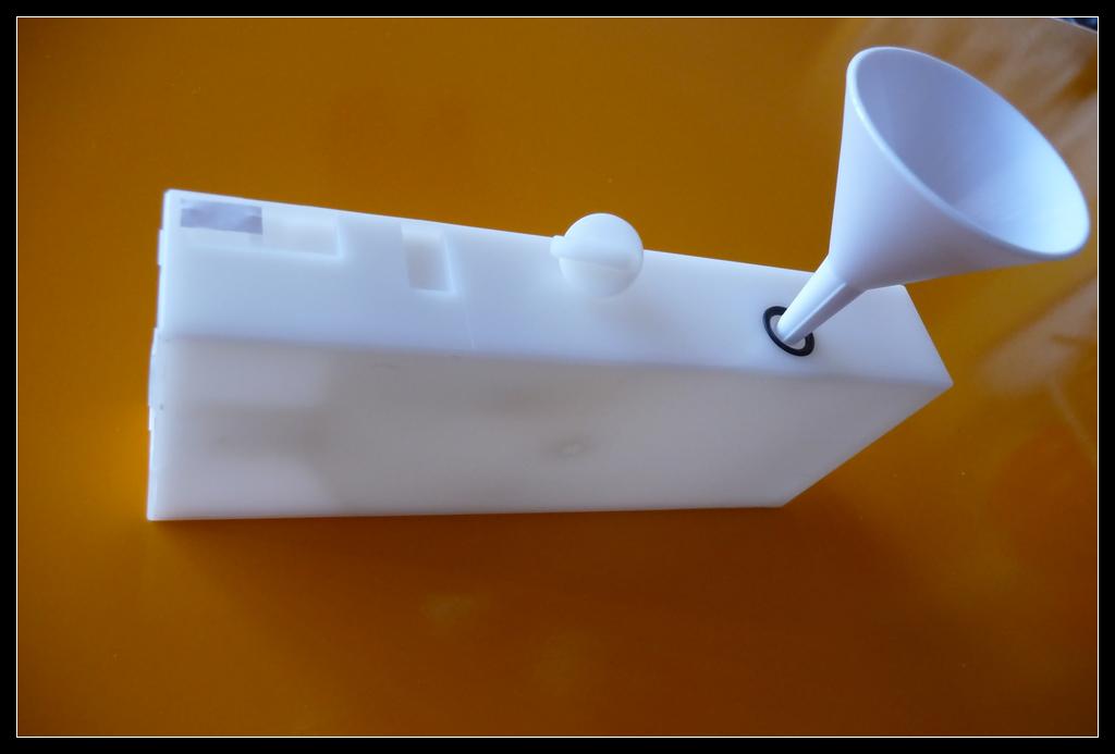

These cartridges are the same size as the original Epson cartridges, enabling you to exchange the cartridges one at a time, when your original Epson cartridges will gradually run out. Also the ink cover can be closed. These cartridges function by using a special tuning chip which sits in a cradle and making contact with the necessary original Epson cartridge chip with the corresponding colour. Together this becomes a auto-reset chip system. Simply removing and re-inserting the cartridge will reset ink level back to 100 % full.
For my previous review of these small size cartridges have a look here:
http://www.nifty-stuff.com/forum/viewtopic.php?id=4746&p=15 at post number 150
One must take care these tuning chip systems must have chips that are not completely registered empty by the printer (lets say: 10-15 %), otherwise there might be problems with recognizing the cartridges.
The only problem is the maintenance tank: To reuse it, you will have to buy a new one or use an expensive resetter ($99) and even this is no guarantee, as I will show later in this review with the expensive resetter I bought a few years ago for my experiment. This resetter is able not only to reset the maintenance tank, but also the original ink cartridge chip.provided it not registered empty by the printer, as this will render this resetter useless.
I have a special always full maintenance tank chip, which I tried in my Epson Pro 3880, but it was refused by the printer. I am not sure what the problem was, as it worked perfectly in my Epson Pro 3800, so maybe there is some firmware upgrade that disables these types of chips.
The only strange design I can observe is the place where the refill plug is positioned. I think it is much better to put the refill plug/hole on the top of the cartridge, so in the catastrophic event it eventually would leak (bad sealing, the ink stays perfectly in the cartridge and does not pour onto your table/desk). Compare this to the design of the Inkrepublic.coms I-refill system: this has the refill hole on top of the cartridge, which is much safer and better.
The first time you must refill and most importantly prime these cartridges (see post: http://www.nifty-stuff.com/forum/viewtopic.php?id=4746&p=15 at post number 150). The priming procedure is only necessary the first time, afterwards just remove the refill plug and inject the ink into the cartridge. Now for refilling you must use a large syringe and corresponding needle (small gauge value, so large internal diameter) to proceed quickly. 20 mls syringe or larger is preferable or refilling can be quite time-consuming , as I have experienced. The problem is when the ink bottle is almost empty and you want to get that last amount of ink out the bottleand your needle is just not able to reach the bottom of the ink bottle. www.octoink.co.uk sells some marvelous squeeze bottles with specially adapted lids with needles attached on it, to overcome this problem. For such relatively large cartridges a (mini) funnel system to refill would be better, so you can pour the ink conveniently into these cartridges. Using a tiny funnel to review the I-refill cartridges is very easy like this:

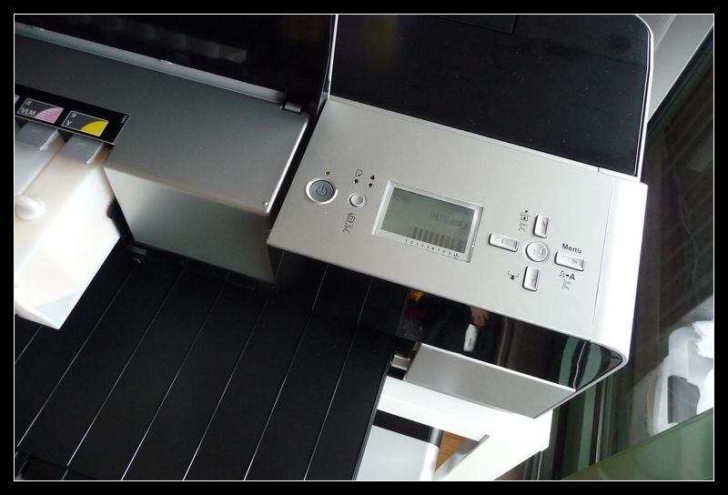

These cartridges will stick out from the printer, so it is esthetically better to remove the ink cover. A very easy thing to do by using a flat screwdriver and pushing away the cover gently from the printer housing. Not necessary, but it looks neater.
The I-refill system uses two master tuning system alongside with 7 of the 9 original Epson cartridge chips, which can be any color. The 8th chip is the maintenance tank: thanks to the advanced reset algorithm the I-refill system drives the maintenance tank chip as well and can be reset too, when it becomes saturated.
How advanced this system is, was proven a few years ago when I had a faulty tuning chip, making it impossible for a working system for my previous Epson Pro 3800 and in the period I needed to wait for the replacement chips, I started to experiment with my special maintenance cartridge resetter, which was able to reset the original cartridge chips as well. All the chips were reset accept the one, which was completely registered empty by the printer, which was LK and a old maintenance tank (which was recognized by the printer as non genuine after reset). After I had received the good replacement chip I could use these 2 chips without any problems, proving its effective reset algorithm.
The I-refill system is more expensive, but you will not need that expensive resetter, necessary for the maintenance tank as with the small size cartridge system.

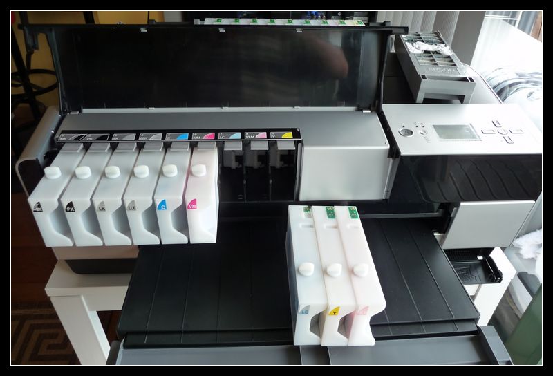

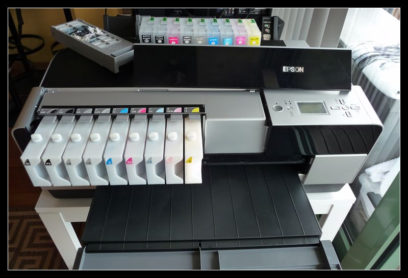

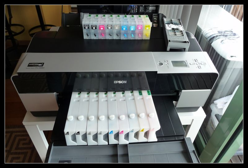

After the previous test with these small size cartridges I installed my new Inkrepublic.com's I-refill system, the version specially for the Epson Pro 3880 with a new version of the IRK4-nano ink with vivid magenta. According to www.inkrepublic.com their IRK4-nano Vivid Magenta has been significantly improved over their previous versions, so I will later on show you these improvements, which indeed are true. The older version of IRK4-nano had some problems with ink flow with certain colors and gives a rather greenish cast when printing in the ABW-mode (Advanced Black and White). Now: this is not something odd, as all the refill inks I have tested had some problems with rendering perfectly neutral ABW prints, as this mode uses some of the light cyan/magenta and yellow inks to support the K, LK and LLk inks in the ABW-mode. A slight imbalance in these light colored inks will cause a color cast in the ABW-mode. My first Image Specialists IM-K4 gave a stronge sepia tone, the first IRK4-nano a greenish cast and the Inkjetfly IMA24/36 gave a strong magenta cast (note: Inkjetfly now sells a newer IMA36 ink set, which might have solved this problem). Also the very cheap OCP K3 ink gave a slight warm tone....but it was much better compared to my previous tested ink sets.
You might have a look at the next pictures, where the small size cartridges were being swapped out for the larger I-refill cartridges:

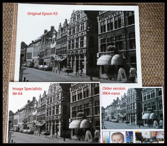

To show you the problem with the ABW-mode I took a picture from some old test prints printed with 3 types of ink: original Epson K3 ink, Image Specialists IM-K4 and the older version IRK4-nano (normal magenta version) and notice the color cast of the Image Specialists and the older version of IRK4-nano:

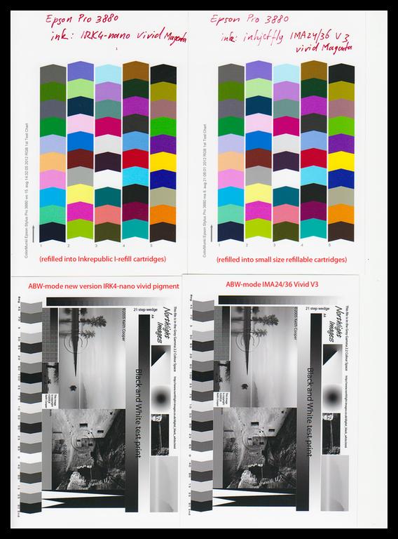

Now have a look at the results of the new version IRK4-nano versus the IMA 24/36 Vivid V3 ink set:
Both ink sets are similar in gamut (see the first set of patches of Colormunki), but have a look at the result of the ABW-mode (setting: neutral, dark). The new version IRK4-nano is now perfectly neutral, whereas the Inkjetfly IMA24/36 Vivid V3 has a slight magenta/warm cast (inkjetfly has upgraded this ink set with a newer IMA36 version). Finally I have found an ink set that gave me completely neutral ABW.
