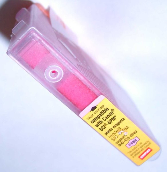

Nifty:
I agree with foto, especially regarding the inadequate venting. I have read the posts regarding the laberynth-like channels that some tanks use to vent. Of course there is apoint of diminishing return, but, to a point, a more generous opening promotes an effecient flow. To make that point I am emailing you a photo of an old empty Staples cartridge that I used (it performed flawlessly) and you can see it has a simple single opening you could put a finishing nail in.
I wish you the very best in resolving the print failure issue. The real danger is, of course, overheating and damaging the print head. I'm probably not alone in recommending that you replace the suspect tanks.

Hey, thanks much for the posts and the suggestions. It's amazing how something so simple can be so complicated.
Too much air in the wrong place = leaking cartridge. Too little air and you don't get any ink.
I'll try a few things and post my results.
Mark thanks for the image... here it is for everyone to enjoy:

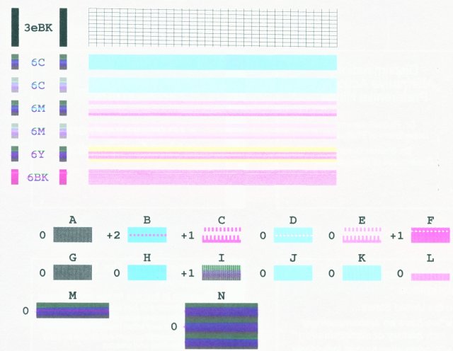

Okay, this is a scary image so if you are squeamish I exhort you to look away and not to continue!
This is the type of nozzle print test pattern / nozzle check pattern I'd expect to see if too much ink is exiting the cartridge.
Notice that the magenta has a blank white band and that it has almost completely taken over the yellow and a little bit of the cyan. The most amazing thing is that there isn't any cross contamination in the yellow and swapping out the magenta fixes the problem instantly.
So, what's causing this? I've left the cartridge sit to drip out any excess ink and everything looks peachy. I've had this happen with a few refill attempts and always attribute it to overfilling. What's odd is that it seems to keep happening to my magenta carts more than any other.

Again, I will refer to he HobbiColor instructions - They mention that the Magenta flow characteristics are slightly different from the others. I don't understand why that would be the case. Although I just purchased a starter kit to try their virgin carts, I won't be using them until the carts I am presently using get tired.
