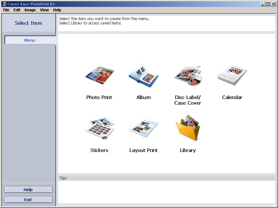

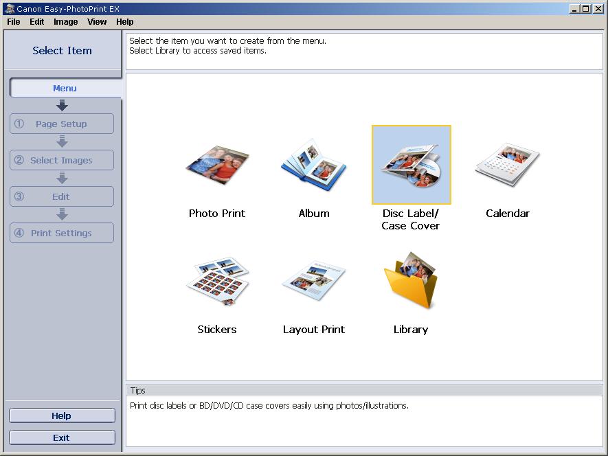

that was the problem PeteBJ we were talking about diferent software i use Canon Easy-PhotoPrint that is much diferent as cd label print the old ones and the problem of easy is the inner outer print area not the are of the hub. but anyway is a great tutorial some one will need this help.

This how it looks like when you start it.
this the part where i select the option
this is the Wrong view as you can check.
as you can see my outer circle size is not enough for complete my dvd i had fix it with surething but we are just talking about this software.
