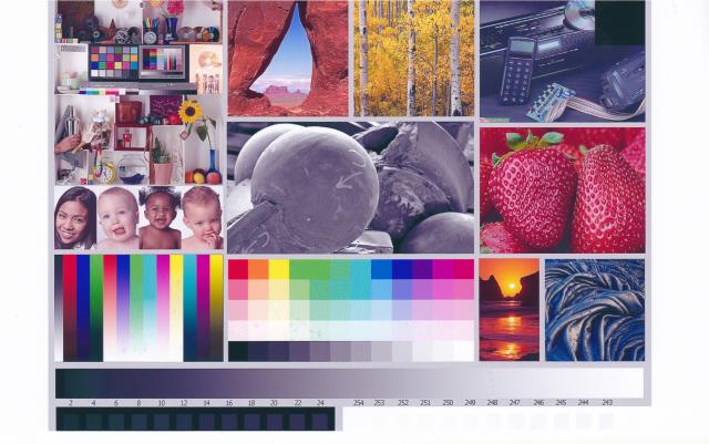

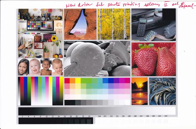

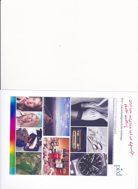

Just bought a used MG5320 and ordered some OCP ink. The result has been awful. While the scanned images here are not accurate (In terms of brightness), I hope the images give a bit of information as to give you idea what I am talking about. >>>
Nozzle check gives very clean output. No color bleed in the cartridges and no ink leak of any kind. I am clueless as to why it would be this off.
Here is MG6120 with IS ink for comparison >>>
BTW, I used Canon Glossy photo paper to print these.

Well, OCP inks do not match OEM Canon OR Epson inks.
They will always need to be profiled to the paper you are using.
I use OCP on my EPSON printers and ALL my papers had to be custom profiled in order to get great accurate colors.
I use Image Specialists inks on my Canons from Precision Colors and those DO match very close to OEM inks as you probably already know.
NOT OCP!!!! OCP is super cheap to print on however you will need custom profiles for your your papers and then you will get excellent results.
Gloss of the Magenta inks is NOT even close to OEM. IS Magenta does not have great gloss either.

Wow, even the cheap after market refilled cartridges from china sold by the likes of Ebay, Amazon and Meritline are miles better than this. Had I known this I would have stayed with IS from Precision Colors rather than venturing out for a different flavor. Did I just flashed $50 down the toilet then? I need to try all Canon ICC profiles from all printers they ever made before I dump this ink. Anybody willing to email me any ICC profiles from any canon printer? I could install the driver for a particular printer from Canon to get the ICC and then uninstall it but that would be a lot of work and would leave a lot of residue folders on my system. Thanks.

The real reason is that the ink colors for the 251/551 carts are different once again.
Well after tackling the Pro-100 and the soon to be popular XP-600. I gotta get cracking on the 551/251 carts. The ink colors are not the same as the 221/226 carts. I will try my best for a custom match..pretty much a requirement these days. Even on the XP600, I hope to have something special as these new Epson using the Claria ink is using a different dithering pattern making certain colors very sensitive.
