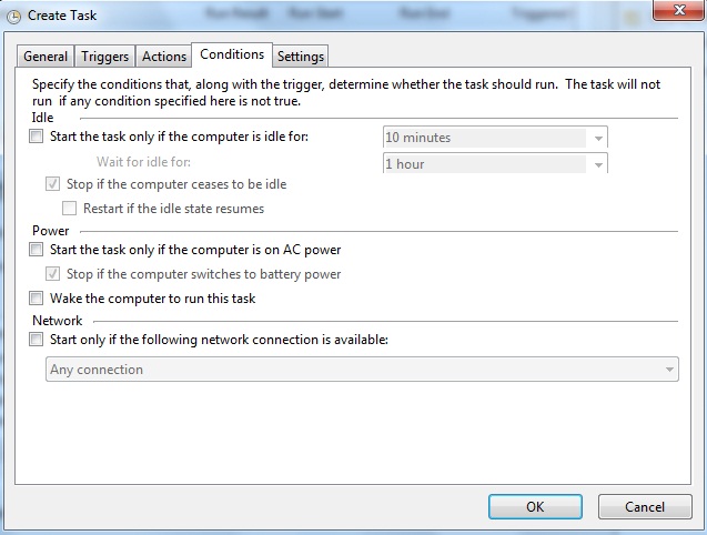

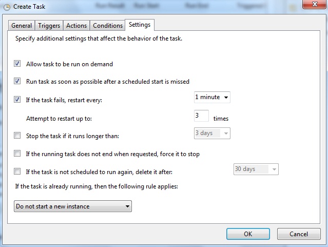

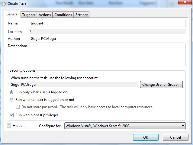

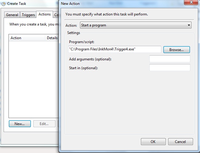

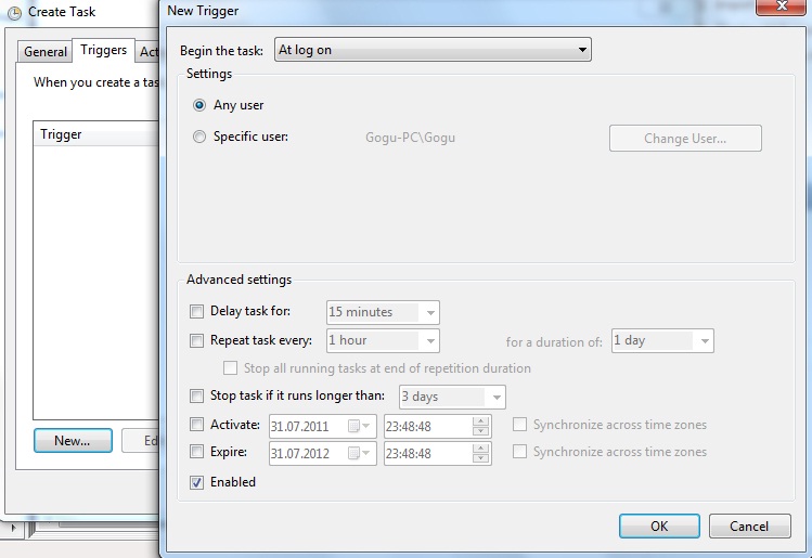

Ok. Have you tried this?
msconfig - tools - computer management - task scheduler - create task

Tried that -no success. Tried a few times changing one item each time, like tried on startup and on login and when user is logged on and not loggd on and a few other options that seemed to make sense. Change definately took as the task was there after a reboot, but trigger never opened automatically. Did a search on exceptions to UAC and your method and a couple third party freeware applications show up. Maybe I'll try something else in future, but that's enough time for this one now. PC is mostly on all the time, so just need to click on the trigger4 when I freshly start PC. Not a biggie. Thanks for your help.
