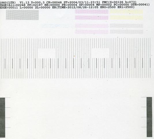

I followed the directions as I understood them but can't get it to do the alternating green/orange lights. I can't select for service mode. It just runs a sheet of paper through with no printing.
popsy
Dec 8, 2005
101
131
Is this the service test print?
popsy
Dec 8, 2005
101
131
Oops that one was tiny. Maybe this is better.
turbguy
Sep 10, 2007
1,562
1,442
Laramie, Wyoming
Canon i960, Canon i9900

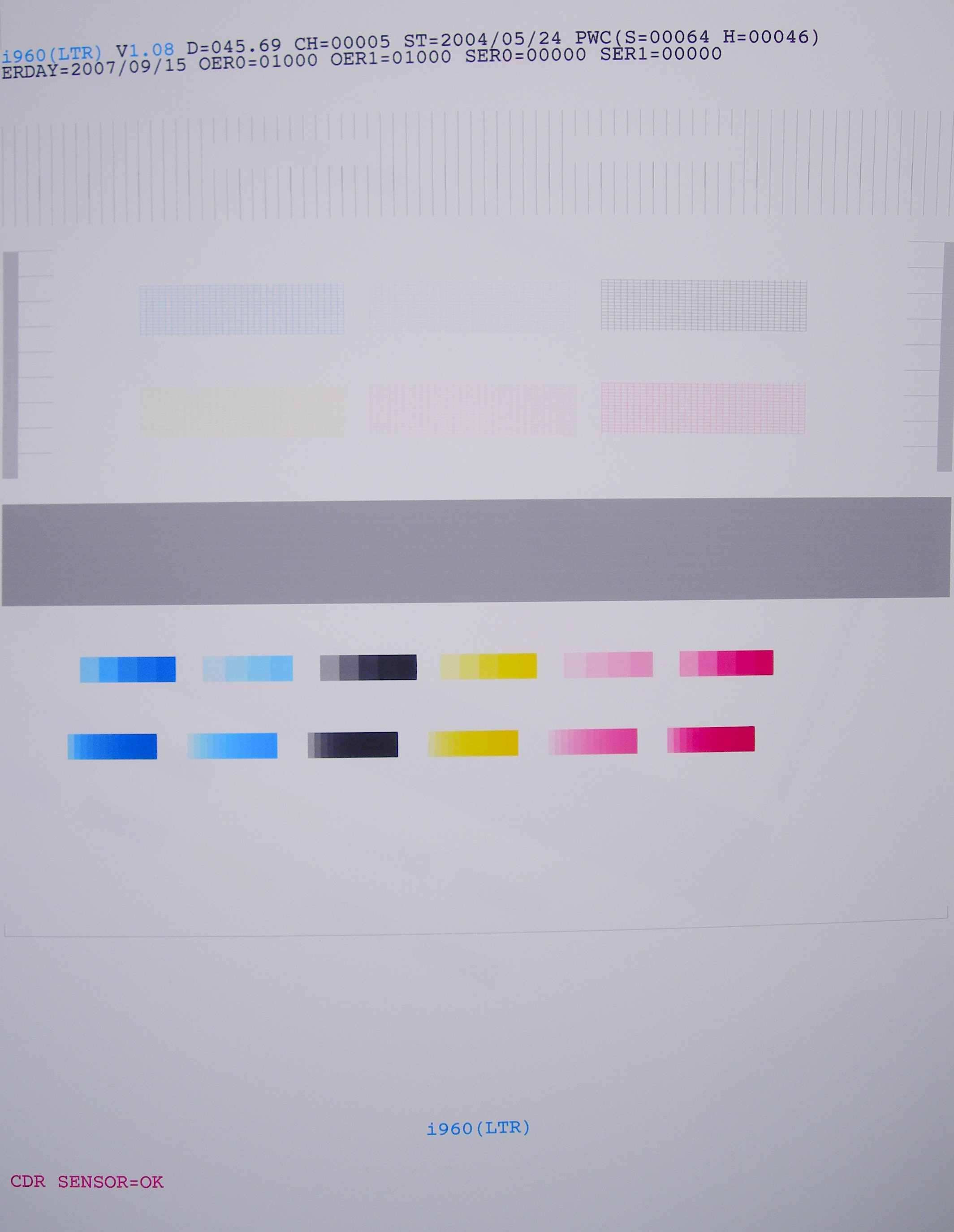

That close, I was expecting the service print to ALSO print all colors in grid fashion below the text (so you could see EACH nozzles performance) so we could see if there was an periodic grid problem in Cyan. See if there are other types of service print options (could be called an EXTENDED nozzle check) in the manual.
Here's a nozzle test print from an i960:
http://www.nifty-stuff.com/forum/uploads/2540_nozzle_check_small.jpg
Here's a service test print from an i960:
http://www.nifty-stuff.com/forum/uploads/2540_extended_nozzle_overal.jpg

Finally I think I followed directions correctly.
turbguy
Sep 10, 2007
1,562
1,442
Laramie, Wyoming
Most disturbing that it show significant cyan issues when compared to the example print on Page 1-20 of the service manual. "Mucho cyan missing", including the large halftone area below the black stripes.
Install a different cyan cart, do a clean, and print another service test print.
If no difference, open the cover and "false out" the cover open switch so that the printer thinks it's closed. Observe a cleaning cycle and see if it is possible to apply a light amount of pressure downwards on the head/cart assembly during cleaning with your fingers. If so, apply some pressure down while its on the purge pads during cleaning and try another service test print. Try to deflect down about 1/16". Particularly press down on the cyan cart if possible...
Report what you find.
