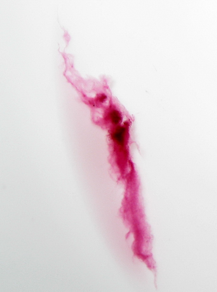

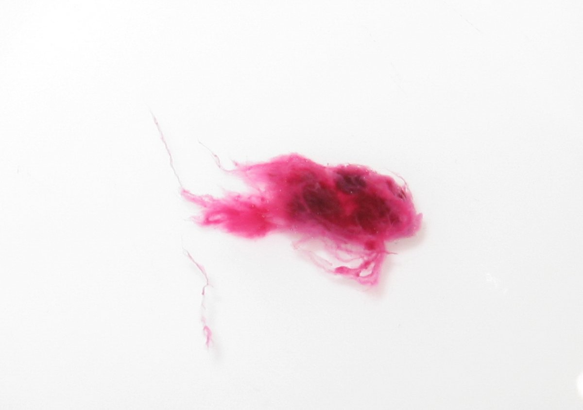

A major part of the ink solvent are glycoles, and that's pretty good nutrition for fungus, so an ink formula
should contain fungicides. They may have been omitted whatever. Fungus in inks is a barely known problem for people refilling, buying larger quantities for a bargain and keeping that at home for an extended time. It may colalgulate but as well develop fungus inside when you open such bottles frequently - nothing is sterile in this area. Ink bottles should be marked with something like 'use within xx months once opened and store at a cool and dry place.'

I can sympathize with you, I had been working for some time in logistics for a major electronics company, shipments can go wrong, even worse than what you describe including robbery of courier cars, funny adresses and lots of fraud attempts with commercial customers, it can go worse with those, and for your type of deliveries nobody would pay for an escrow service. At the end we had a special internal investigation service to check and validate addresses of new customers via Internet/phonebooks , zip code listings etc, we got orders entered like from Mr. Chubachev in Almaty - nothing more............and you ask yourself whether that place is the real center of the world and everybody should know that guy....
Biocides have always been part of the ink mix and the biocide used in the previous 14 years either is no longer effective with this particular strain or some strain has evolved. I have been in contention with 5 phDs about this for over a month now. Oh yeah, the dye supplier says it is chemistry related, the biocide supplier says that too much is being used. None of these proposals support the fact that the some of the inks had been in production for over 10 years with no problems with chemistry...and why now...and only in flareups not a whole batch. I don't make the stuff and the formula is top secret so I am only getting tidbits as a purchaser. And I am finding it better than the big buck lab.

' only in flareups not a whole batch' - that makes it even more difficult - is it customer related ? Could it be temperature related ? Are you rebottling ? Are those bottles clean ? Some fungicides , their concentration is just good enough to prevent spores to sprout, but once they start growing they are not so effective anymore. So it's like chasing some resistant bacteria without much possibility to check and investigate on the trail to the customer and there over time. The formula for the ink may be the same over a long time, but something may have changed, a supplier for the raw material, for the solvents, changes in the process equipment, you would have to get some biological detectives into the investigation, but since that is not at all health related the cost will be much too high for this type of product I guess.
Well I purchase and reship and it is only in occasional samples even at the gallon level! So if you sample into a batch of say 60 gallons you can easily come up empty with nothing BUT a gallon or two might carry the spore. It is only in certain colors and inks containing one of multiple dyes. My early guess is that the source is at the dye and this one dye. Evidence points to this.
The problem is that only chemists are employed by ink mfrs. Chemists only see chemical issues and don't recognize microbial things. Life is too short to argue with pHDs.
The source is not at my location as I finally found one sample in sealed bottles from the supplier. They test their stock and they come up empty! So my issue raised fell on deaf ears.
You are one of the few who understand how difficult this situation is. I welcome and appreciate your opinion as even without biological training I think I figured out what the problem really was....the chemists found some instabilities in the inks in certain situations but could not explain what was presented but stick with the chemical hypothesesis.
Many don't appreciate the complexity of chasing out the real problem. When nature acts up out of the blue what do you do? What can you do> and you will not see this issue for a long time till it pops up. Initially all the characteristics of the perfect ink tests fine and even when the spores have grown, I suspect it tests fine till it grows and grows.
As some know already, the quickest solution for me is to switch suppliers of the inks involved hoping that the new supplier does not get dye from the same source or connected sources. Yes, i wondered how much bilogical directives would cost the mfr.

Oh, I had been in QC (no inks), where I needed some investigative talent, and I know that lots of things are possible - much more than Murphy ever could come up with....o.k., let's close the ink issue and I hope your problems are solved with the new supplier and you can run your business.
