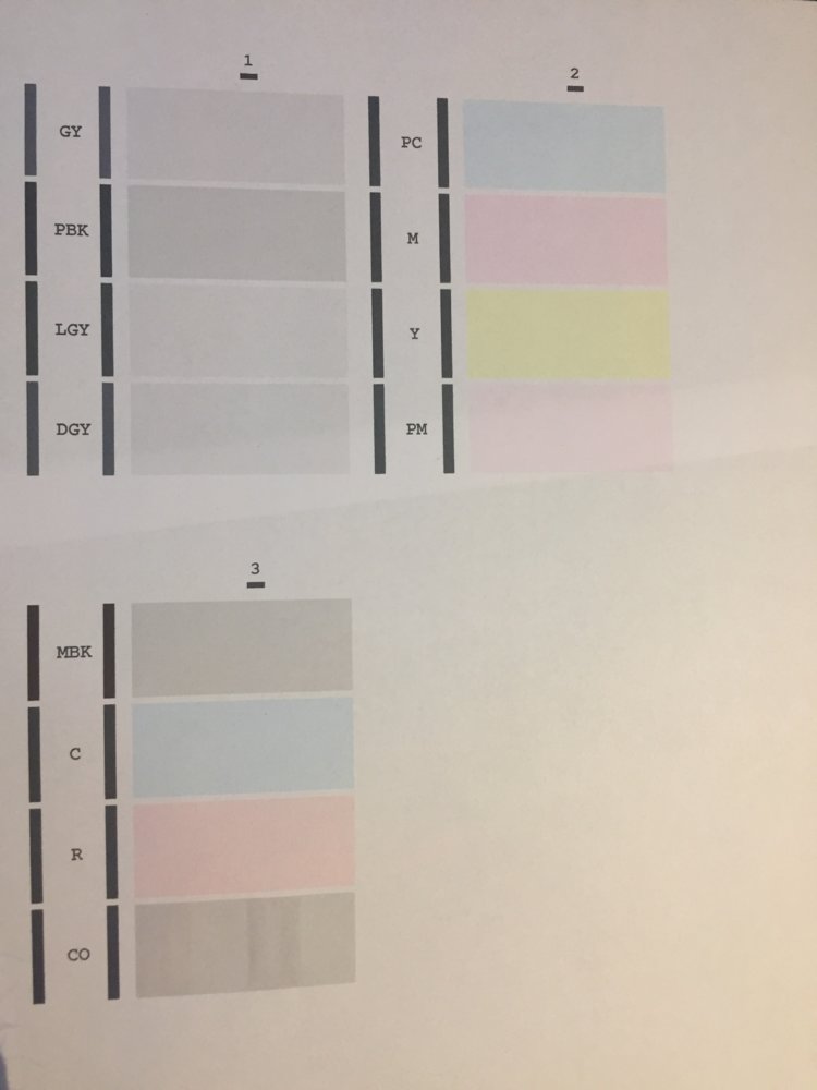

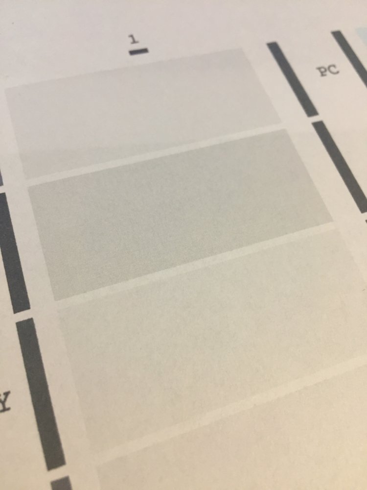

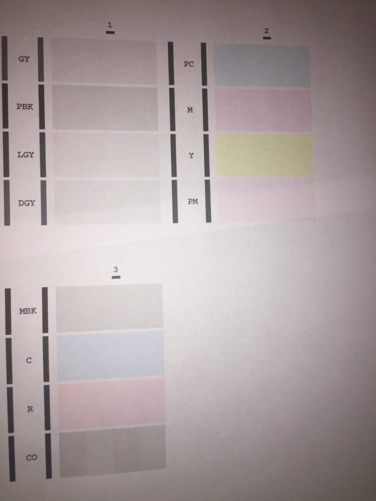

All the Cards are OEM. Just got replaced the empty cards with new ones and nozzle check looks good.
On the PBK i kind of see some lines but not really sure. Not much experience with clogged nozzles, so can the clogg be so small ?
See pictures bellow, and feel free to comment.

Way to go, because you’ve just got a get out of jail free card.
Everything is perfect, now enjoy your new printer...:thumbsup
