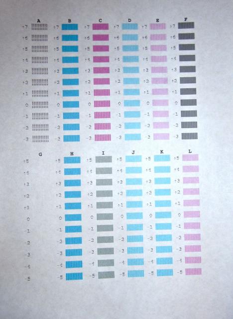

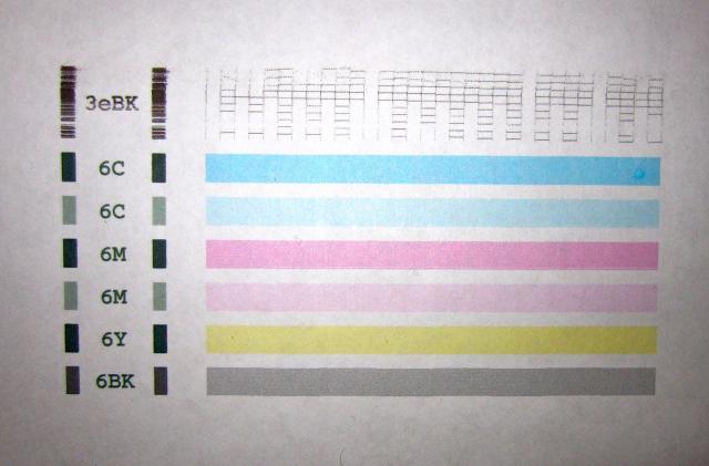

I have a Canon Pixma IP4000, lately the printing of black text has been blurry.
I have done a Nozzle clean, and a deep nozzle clean using the Canon software (I'm using a Mac).. and tried the Print Head Alignment settings.. but without any luck.
My test print shows all inks working well except the 3eBK, which looks like a fuzzy bar code on the left, very uneven pattern on the right..

Here are the print outs:

From your uploaded nozzle check it is seen that the PGBK nozzles are badly clogged. But this is not the worst. The "picket fence" like pattern suggests an electronic failure in the printhead. Only a new printhead might help. I think that the printhead QY6-0049 will be hard to find and expensive.
It is risky to replace a defective Canon printhead, A defective printhead might damage the logic board, and a damaged logic board will damage the new printhead. So replacing the printhead is a gamble, and sadly I cannot give you odds for success.
Third party ink cartridges have damaged many Pixma 4000 printers, most often by clogging PGBK nozzles. I own four of these printers, which I got for free form friends and colleagues, after they were ruined by too cheap ink bought on Ebay, and only one is in working order, and that is because I bought a new printhead for it. The other three printers are only kept for spares.
But maybe your Pixma 4000 printhead just died from old age? It might be 10 years old. Canon printheads can and do also fail for no apparent reason, so the printhead failure needs not be connected to the clogged nozzles.

If that were my printer I would be trying to clean out the clog in the print head.
I have had test prints that looked worse than that and brought the print head back from the dead. I have also had several 3000 and 4000 print heads that never came back.
