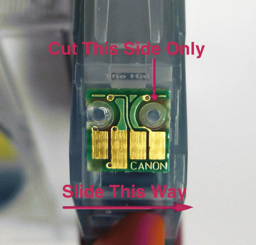

The best way to remove a Canon chip from their cartridge is to just cut one side
of the little plastic nipple that holds the chip to the cartridge (right side).
Then its only a matter of sliding the chip sideways off the second nipple to free it.
When mounting it on a new cartridge it may also be possible to just to slide it on without the use of any glue..
