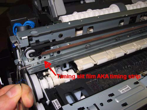

This is most likely an indication that the timing strip, a small dark gray plastic band that passes the rear side of the printhead carriage through a sensor, is contaminated. I'm using Q-Tips with a window cleaner to
wipe over this band. Access is sometimes somewhat difficult and depends how wide you can open printer with the scanner on top.
This is a recent image of a Canon printer with the same problem supposedly, it does not look much different in this respect in an Epson printer

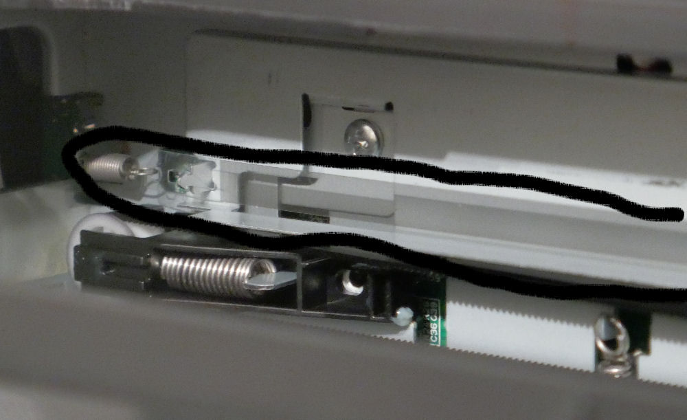

'I cleaned anything I could inside the printer but it all looked fine.'
- Did you run a cleaning cycle or two via the driver - on the maintenance tab - or with WicReset ?
- This is the left end of the coding strip hooked up to a spring

The white band in the printer seems spotless. I ran my finger across it and nothing came off.
Please check again, the white band is a flat cable with signals for the printhead.
You see the coding strip in your image as well - there is the toothed ribbon driving the printhead carriage, and there is a small gray translucent plastic band just above it - hooke up to a spring in the top left corner. Please try to clean this band
carefully

We cleaned the translucent strip with a cotton bud + window cleaner and the strip/bud it was absolutely spotless.
Same issues are occuring, unfortunately.
