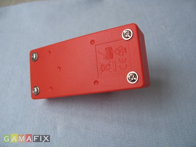

4. RKS resetter a.k.a RedSetter battery replacement mod.
Using a knife or other sharp tool and a steady hand you must insert it about in the middle of the device (there is no glue) and carefully slide the knife to the corner.
Now carefully twist the knife to the side to snap or pull out if it is badly glued the plastic pins that holds the cover.
This is how it looks open. You can see 4 plastic pins that holds the cover.
In my case 2 was removed and another two broke.
Use a knife to carefully cut the plastic where the screw will later go.
When you are done it should look like this.
Now we need to remove the broken plastic because we will use screws to hold our cover.
Use a drill bit that is 2.2 millimeters.
Be careful not to drill too deep, use a hand drill not electric.
You can see how it needs to look like when you are done.
It’s time to make some holes for screws in the cover. For this task we will use standard computer screws and drill bit that is 3.2 millimeters.
As I said above we use standard computer screws that are made for plastic. You can ask for these in any computer store tech. department
The glory of how it looks once we put all parts together. It looks like it was made like this in the factory LOL.
Here is another close up picture. Now you can change the battery anytime you need.
Optional thing is to add rubber pads so the device would not slip on the table.
