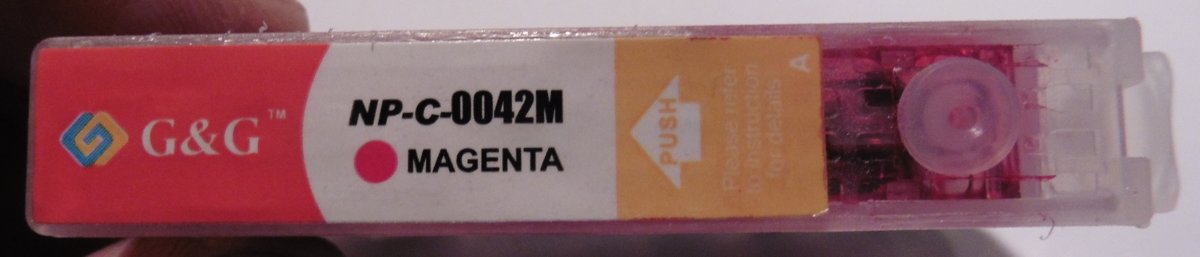

Thanks for all your replies. I had watched the good videos from Jose. Unfortunately they don't mention anything about the carts (see attached).
First I need to apologies, that I referenced the wrong carts. Sorry, I didn't look, I assumed I had OEM Canon. In fact I have G&G filled replacement carts. This only proves that Joe has a good nose :)
I have now researched the G&G, and find that their inks apparently do not mix well with PC. So I have definitively confirmed that the problem is my fault. This now raises the question should I get new carts, or should I flush and dry the G&G carts.

Using Canon OEM CLI-42 cartridges are the only way to go. They last through many refills and are basically trouble-free if used properly. I'd totally forget about 3rd party cartridges for refilling a Pro 100. You will save a ton of money just by refilling. The cost of a couple of sets of empties will pale in comparison to having issues with 3rd party ones.

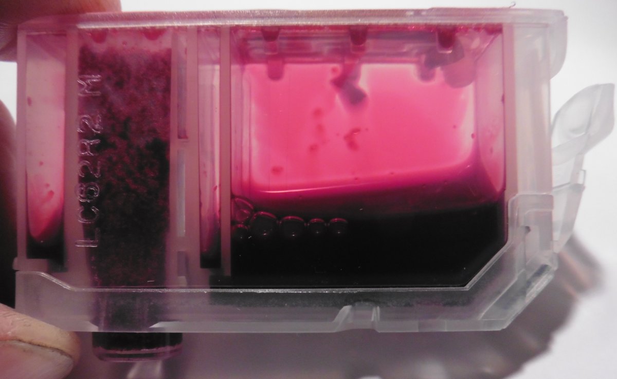

They are not even refillable. They are intended for single use. It looks to me like The vent hole was drilled larger and used for refilling and sealed using a silicone plug. There are several channels in these cartridges for air and ink. Vent air goes from the vent opening to an air chamber through the green channel and from the air chamber to the sponge chamber through the yellow channel. Ink passes from the reservoir to the sponge through the serpentine (cyan) on the side of the cartridge.
Drilling the vent hole and plugging it interferes with the intended function of the cartridges. It is not recommended but if you want to refill those cartridges, then Freedom Refill seems to work well. At least for filling the reservoir and clearing the vent system. Priming the serpentine might be a problem. I have only done a test refill using water, I have no intention of reusing these cartridges.

Why did I use the G&G? I don’t really know. I suppose because they were available at the booth at our local market, where I had been getting carts refilled for years. That changed with the Pro-100. The guy now had packaged carts, at considerably lower cost than the OEM from Canon. So that’s where the G&G came into the picture. They worked fine. But then I had never tried to refill them. That’s where recently the problem started, and mostly, I know now, due to a lack of homework on my part. Unfortunately the original OEM Canon carts are long gone, but I still have the original clip-ons.
Anyway, the (unsatisfactorily) refilled G&G are now in the trash. Last night I did try to flush a G&G, and true to others predictions, that did not go well. The G&G are definitively made to be essentially not flushable. I did succeed to say 99%, with a lot of quizzing and sucking, all the while turning and rotating the cart. Took almost an hour. But what is really impossible in the end is the drying. Because of the multiple passages (see PeterBJ’s post; thanks for the explanation) there is no way to get all the flush-fluid out sufficiently for refilling with ink. So all in all, it proves that the G&G are not refillable.
