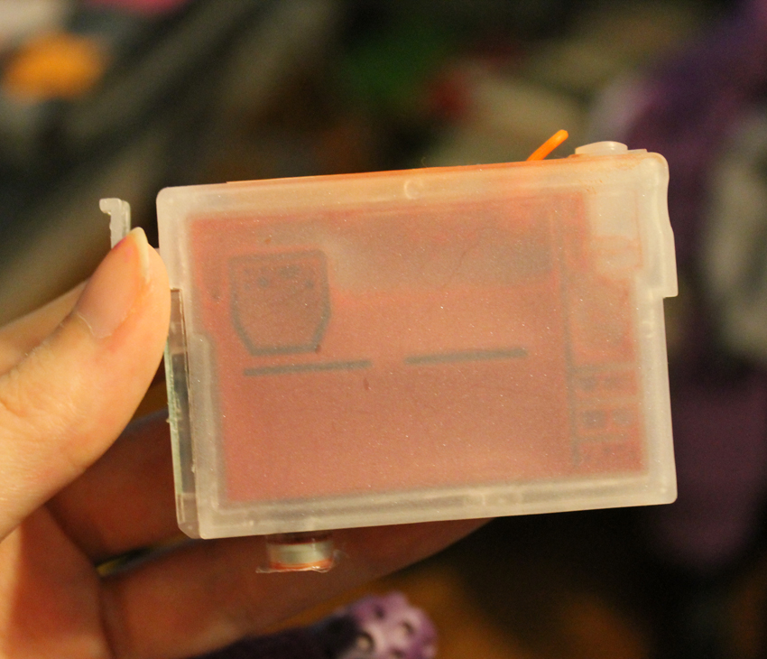

Hi everyone! I've been a long time lurker and have had many questions and issues resolved just by searching the forum. This time though I need a bit of advice! I'm gonna try and give as much info as possible...so this post may be a bit long.
I have refill carts for my r1900 from precision colors. For months my orange cart was leaking and nothing I did would stop the leak. Mike graciously sent me a new orange cart about a month ago and everything was great!
But...my computer broke 2 weeks ago and was unable to print for 2 weeks (it was fixed this past Tuesday). Last night I did some nozzle checks and the first two were fine and then the orange just stopped flowing. I cleaned the purge pad using jtoolman's video and parked the print head over it for 3 hours or so. I also did the windex soaked paper towel under the print head.
At this point I am thinking it's not dried ink and think it's air caught somewhere. I noticed a large air bubble in the priming chamber of the orange (I think that is what its called) and used jtoolman's other video (https://www.youtube.com/watch?v=hh2wuzwezxM) to try to prime it and get the air out. All my carts are like the ones in the video except the problematic orange cart which has the chamber up higher so I don't know if the technique in the video is sufficient for this specific cart.
Anyway...I've done probably 10 cleanings now and still isn't flowing. I managed twice now to get a decent nozzle check but still had some missing lines. Each time this has happened and I ran another cleaning then nozzle check and the orange stops flowing altogether once again.
At this point I am not sure what to do!! I don't want to throw it out and buy a new printer after I had to spend over $300 to fix my computer. >: Not sure what my next step is though. Is it possible the cart is bad?

At this point I need to know what you are actually running. What type is the Orange one and what type are the other 7?
Either one is good. One type will self prime. Another type needs to be manually primed if you run them very low.
It has happened to me too many times to even count.
Some shots of both of your cart types would better illustrate the whole situation.
Oh and Mike is one of top experts here!!!
Joe

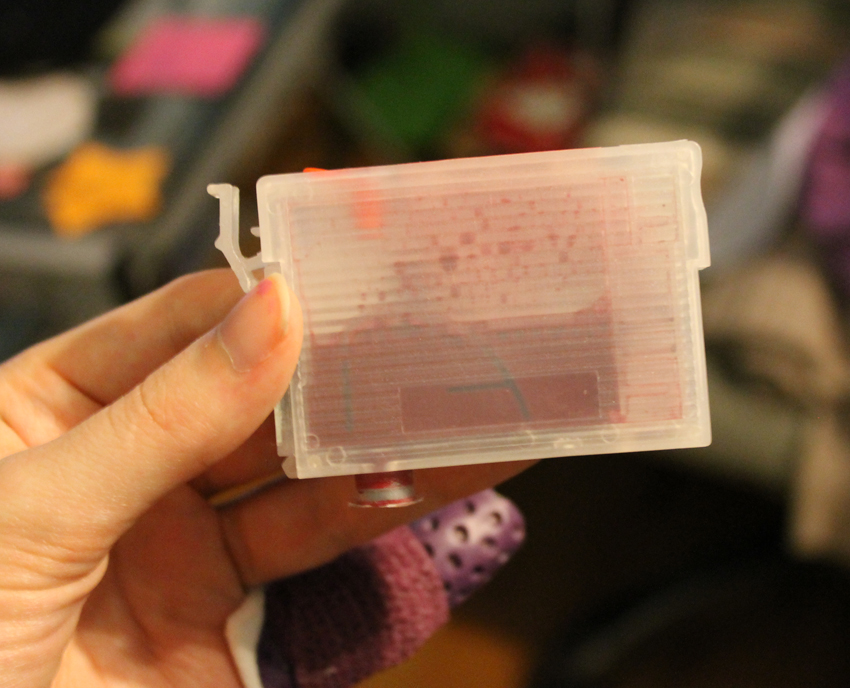

Alright, I took some pictures of the orange cart and one of the other seven. Oh and don't mind my finger! I'm recovering from surgery on my pinky finger. :) If you need more pictures let me know.
This is the orange one which has the chamber up top. As you can see there are air bubbles in the chamber, but not sure how to prime this cart.
This is the my red cart and all the other carts match this one. I believe these are the same carts that are in your refilling video. I haven't really had any issues with these carts, except the orange leaky cart that was replaced.

Your other 7 carts are the auto priming type.
Your Orange one requires priming. The upper left chamber seems to have enough ink in it. You will never truly remove all the air.
One suggestion is to fill it up once again and the insert a plain syringe into the exit port. Holding the cart upright. Aspirate a bit of ink and that should remove any possible air you may have in the priming chamber and the line serpentine ink line that leads back down to the exit chamber.

Alright, I feel really silly now! I didn't realize this cart had a vent plug, cause all the others just had tape that you removed before putting it in. I removed the vent plug and I'm sure after a few cleaning cycles it will work fine.
Thank you for your help...probably wouldn't have realized that without it!

But I now CLEARLY see that YOU had the vent plug in place right on your photo of the culprit cart!
Shame on me too, for NOT seeing that!
