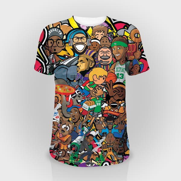

sublimation is perfected by the industry check google images for some examples
here an all over shirt
http://s3.amazonaws.com/assets.jakp...sub/all-over-full-color-best-illustration.jpg
you would need at least a2 size for that
