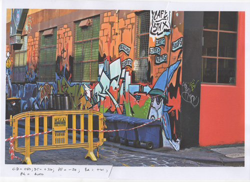

Well! I have some boring 'ol Cone K3 pigment in my 3880, either late 2012 or early 2013 (I did little printing 2013) so all the images I made are at least 18 months old. I did a bit of a tidy up earlier this month and found this sitting on a shelf of a book case directly under a window facing WEST. Sun is from the North and we have very large windows on all 4 walls of the study that means it got FULL sun for 50% and indirect for 100%.
The paper is Xerox iGen 3. Apart from turned up edges and a difference in the BRIGHTNESS setting Left was +61 and right was only +53. I cant pick any point of difference.
Image on the left is the exposed image. Note paper colour also!

Hi 3dogs: well I wasn't surprised with pigment ink holding its brightness after long exposure to solar irradation, as pigment inks are always very fade resistant. No: most importantly are the test for dye inks, which known to be susceptible to fading even after a few months. As you can see my test with OCP pigment ink also doesn't show any fading.

@3dogs That's an interesting picture. The colours are unusual and if you copy the image and try printing it, the results on a dye printer are not good in comparison to your original.
