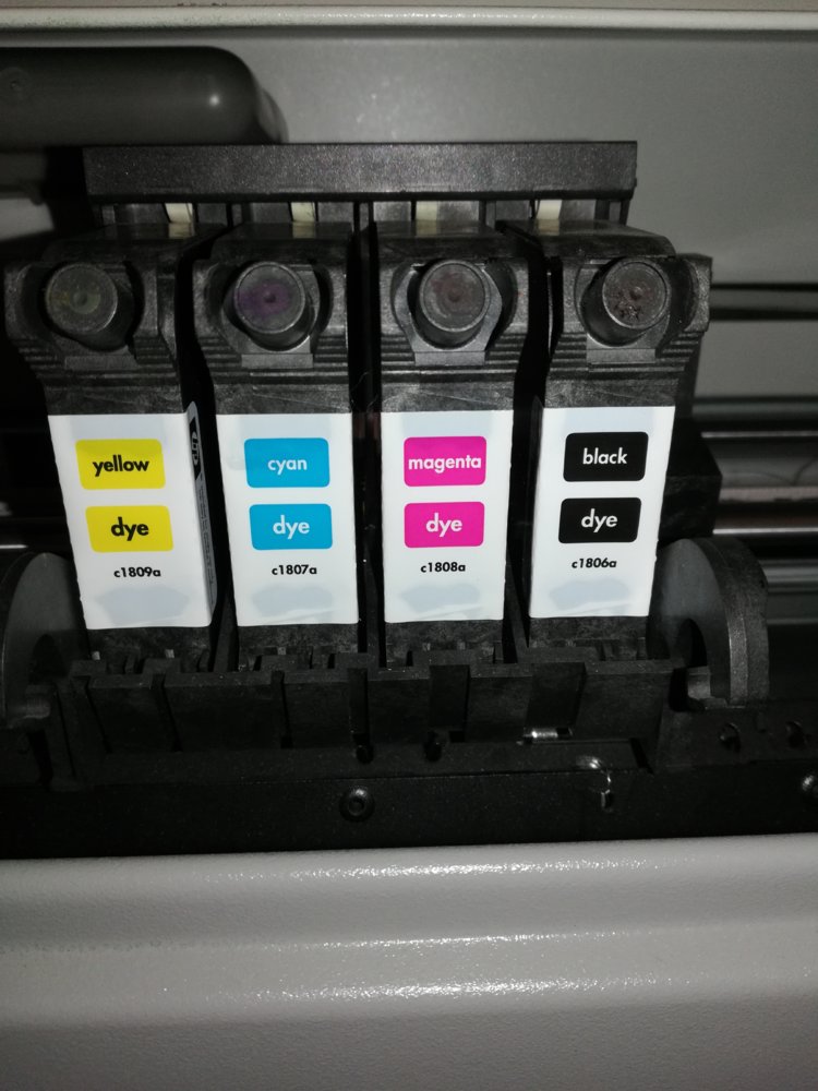

Hello friends,
I am writing to you to see if anyone can help me.
I have a hp designjet 3000cp, this equipment recovered it as damaged and it managed to work, after changing several parts, it presents the error 050000.
in solution I only find this.
https://support.hp.com/us-en/document/c00010030#AbT40
I already relize the cleaned cleaning without any changes.
Suggestions are accepted.

Hello Kolvin,
Thanks for your good suggestion.
I already solved the problem (The media sensor was dirty due to ink residues).
Now I present another problem, I can not find the cartridges that this equipment uses, if someone helps me with the compatibility of cartridges if it exists ??
Any website that sells cartridges for these teams would be useful, but I think they are obsolete.
Thanks...
