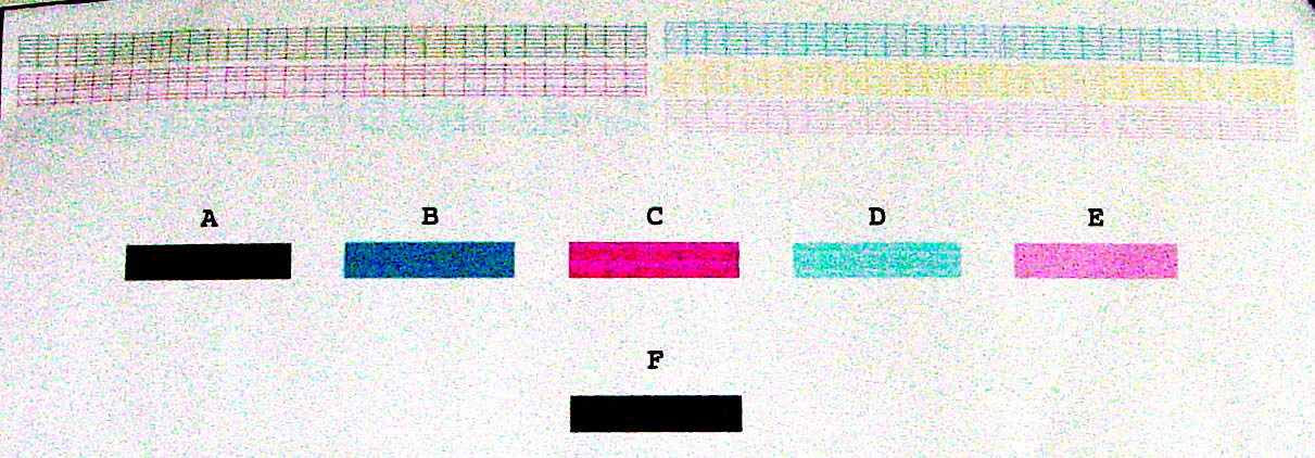

I have been battling with poor nozzle checks on a Canon S800. I have done about all of the cleaning methods (at least all those that I can find). The canned air seems to have even made things worse. This is what it was when I tried to finish opening it up
and this is what I get now after
(Please disregard the colors in these shots; I had to play with levels in PhotoShop to get the lines of the nozzle checks to show and there still isn't enough contrast for the PC to show.) I did try with different ink tanks and that doesnt seem to make any difference.

Jane,
A few questions:
1. What inks are you using?
2. If you ignore the problems with the nozzle checks, do you see any other problems when printing?
3. It is hard to tell from the image, but are the problems confined to the photo magenta and photo cyan?
4. Are the 6 color bars solid, or do they have lines where ink is missing?
These nozzle check patterns are typical of what I call a "nozzle firing" problem, and are usually related to an ink problem. Would it be possible to get a better picture/scan of this printout? Printing on glossy photo paper sometimes gives a better image.

2a. When printing the MIS "purging test pattern - 6 color printers" I get banding of magenta, cyan, and photo magenta with the most pronounced in the magenta unless I kick quality all the way up to the "fine" end when set to Standard, plain paper and auto output. This driver has five ticks to the quality setting. The "standard" plain paper one is the 2nd from the "fast" end. The center one is grayed out. When set to the one just left of the "fine" end the magenta has almost a brick like pattern to it and is generally lighter than normal; there is a very slight banding in the photo cyan and a bit more in photo magenta. On "fine" magenta is the one that has more of a "noise" look to it than banding and is generally lighter than normal. What has done the best over the years for photos is on Jet Print papers set to "super photo", "high gloss photo film", "Fine", "Image Optimizer and Image Optimizer PRO" both OFF, color adjustment checked, use ICM NOT checked, output style "accurate", Brightness "normal", Intensity" on center setting and no special effects. When the test is printed this way the magenta shows a very slight just not as smooth quality as normal and somewhat lighter than normal. Actual photos it is hard to describe but doesn't match screen as it did before. Incidently, I have been using MIS ink for years.
3a. The problems are mainly in the magenta and to a lesser extent in the photo cyan.
4a. The "C" bar (which is magenta) has a couple of white lines in it.
A. I too was very disapointed at how this showed up when posted. I had done a photo of the printouts (outdoors) as they do not want to scan will. Also, think the small size of what shows up in a post is a factor. Is there a way I could e-mail you a larger copy?

Can you print this image using the settings that maximize the problem and then scan it or take a picture of it? Crop it tight, change the image size to 1500 pixels on the vertical axis and reduce the jpg "quality" setting to get its size under 250Kb (the original is only 59k at 800x1050 pixels). Don't adjust anything else in PS - post the uncorrected image.

Here are a few scans one as per Grandads suggestion. The first is a printout of the file that Grandad suggested
the second is a scan of a printout of the MIS file Purge 6
the third is a scan of just part of a nozzel check which I hope shows the missing segments better than the earlier post of a nozzel check
I am not sure what happened to this during the upload process in viewing the preview of my post there is distortion in the nozzel check one (the last item) which on my monitor before uploading is very clear especially if viewed at 100%. There are NO missing segments of horizontal lines in the black, 2 missing segments of horizontal lines in the cyan, the magenta has been the big problem and I haven't counted, there are none missing in the yellow, quite a few are missing in the photo (or light) cyan but have not counted, and finally none are missing in the photo magenta.
All comments welcome
