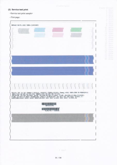

After a lot of messing about looking at the manual changing carts, poking the purge pads which do not seem that dirty. Any pressure they tilt downwards and on release come back up, this I assume is their normal position?.
Before attempting to get into service mode I checked the MP640 manual and printed off several pages likely to be of interest. A copy of the scan is shown above and if you look carefully various sections either do not line up or are distorted. This is the first time I have noticed this as I have printed about 30 pages of text trying to get to the bottom of this malfunction, and apart from the bumping noise, not noticed any text distortion.

Further to my last post, I have examined more closely the printed output and text is being scrambled on some pages. Also downloaded the Service Tool via the link in Tudor post but cannot get any of them to work. They are all greyed out. Tried compatibility XP service pack2 windows 7 tried running compatibily checks via windows 7 64 but nothing seems to work.
