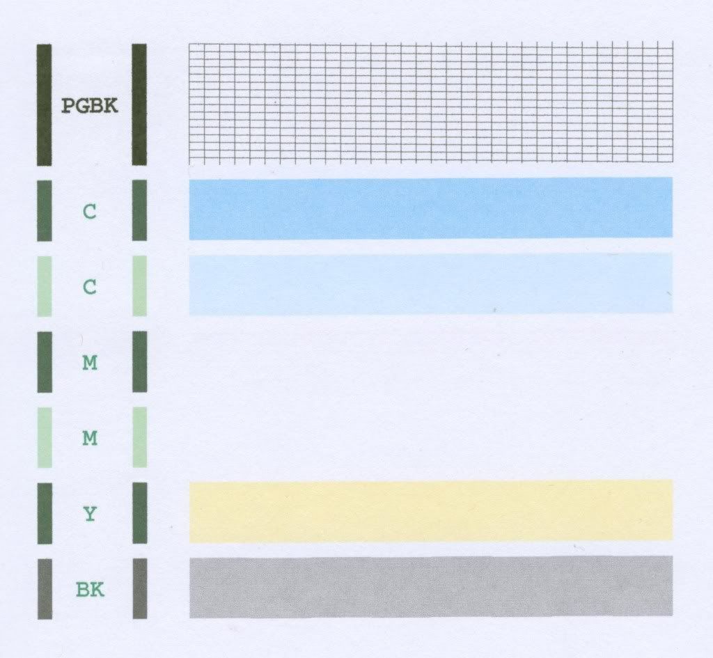

Thanks for your replies. I tried what you suggested to clean the purge pads and the liquid (Windex) did dissipate after starting back up. I then did a nozzle check with these results. Still no Magenta. What do you suggest I try next?

It looks like there is a tiny amount of magenta on the upper block which is a good sign if true.
I would suggest that you just keep putting Windex on the larger purge pad and do a normal cleaning cycle on the dye inks once per day. When it's done put some more Windex on the purge pad and let it sit until the next day. If you have a syringe, you could also put a couple drops of Windex on the inlet port for the magenta ink on the top of the print head. You will have to remove the cartridge to do this.
Also, leave the printer turned on all the time.
