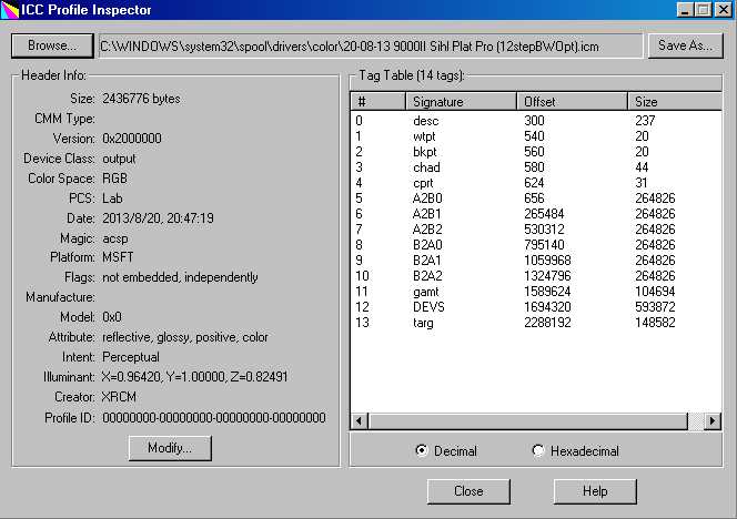

I find that the ICC Profile Inspector software tool will provide the answers on profile sizes. The front page image of one of my Sihl paper profiles is below, click to enlarge.
The profile size in the Windows directory listing is 2380 KB. The Profile Inspector front page shows Size as 2436776 bytes or 2436KB. The total of the Tag Table "Size" column is 2436456 bytes, all reasonably similar, except Windows!
You can click on the individual tags in Profile Inspector and they open up additional pages.
Now I would like to see the equivalent for an ArgyllCMS profile or better still, be sent a copy of a profile!:bow
Also see http://www.color.org/ICC_Minor_Revision_for_Web.pdf, document page 11. (PDF page 20), for a profile map.
See also Table 20 PDF page 28, document page 19, for Tag details.
Summarising the Tags:- Description, White point, Black point, Chromatic Adaptation, Copyright, A2B and B2A, Gamut, DeviceSettingsTag - Specifies the device settings for which the profile is valid, Characterization target.
