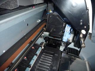

Thanks for coming back so quickly. The problem is getting the printhead carriage out into the open; on shut down it hides in the cave behind the cartridges. I don't know if the image has uploaded right but what it shows is my grubby finger pointing into said cave.
Is there some ratchet that allows the carriage to be released and slid by hand into the open?
Here is the printhead hiding in its shameful hole; the belt can't be moved by hand unless there is a release somewhere.

I have never seen a printer like this. I presume the ink cartridges are stationary as shown in your picture off to the right?
When you open the cover, does the print head move to the center, even momentarily? If so, you could unplug it while it is in the act, but I have no idea whether this could have any adverse affects. I'm more of a novice regarding this printer than you are.

No it doesn't let you in while the cover is up. I could try disengaging the switches on the cover lock and catch it before the carriage whizzes back.

maybe a bit late to add: If you press the online button to switch it offline, the display should read FeedPaper. Press and hold the left cursor. The printhead moves to middle of the print area and the lid unlocks.
