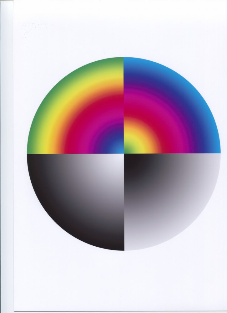

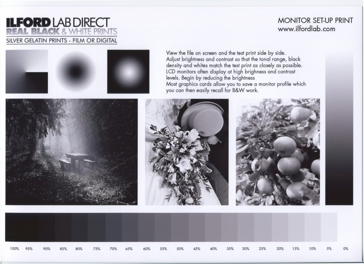

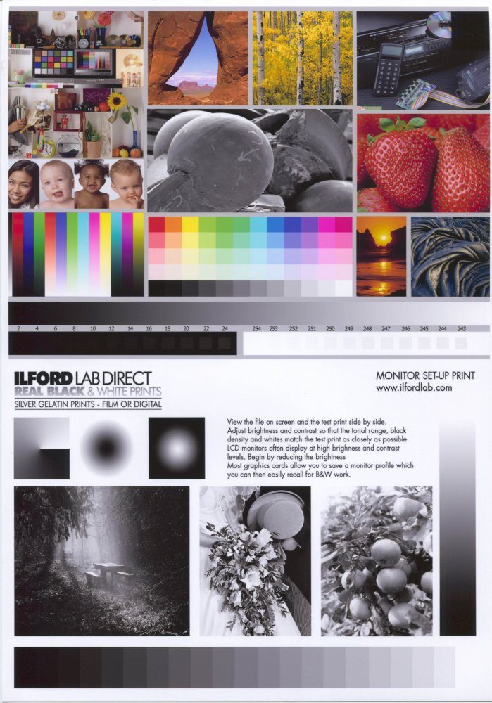

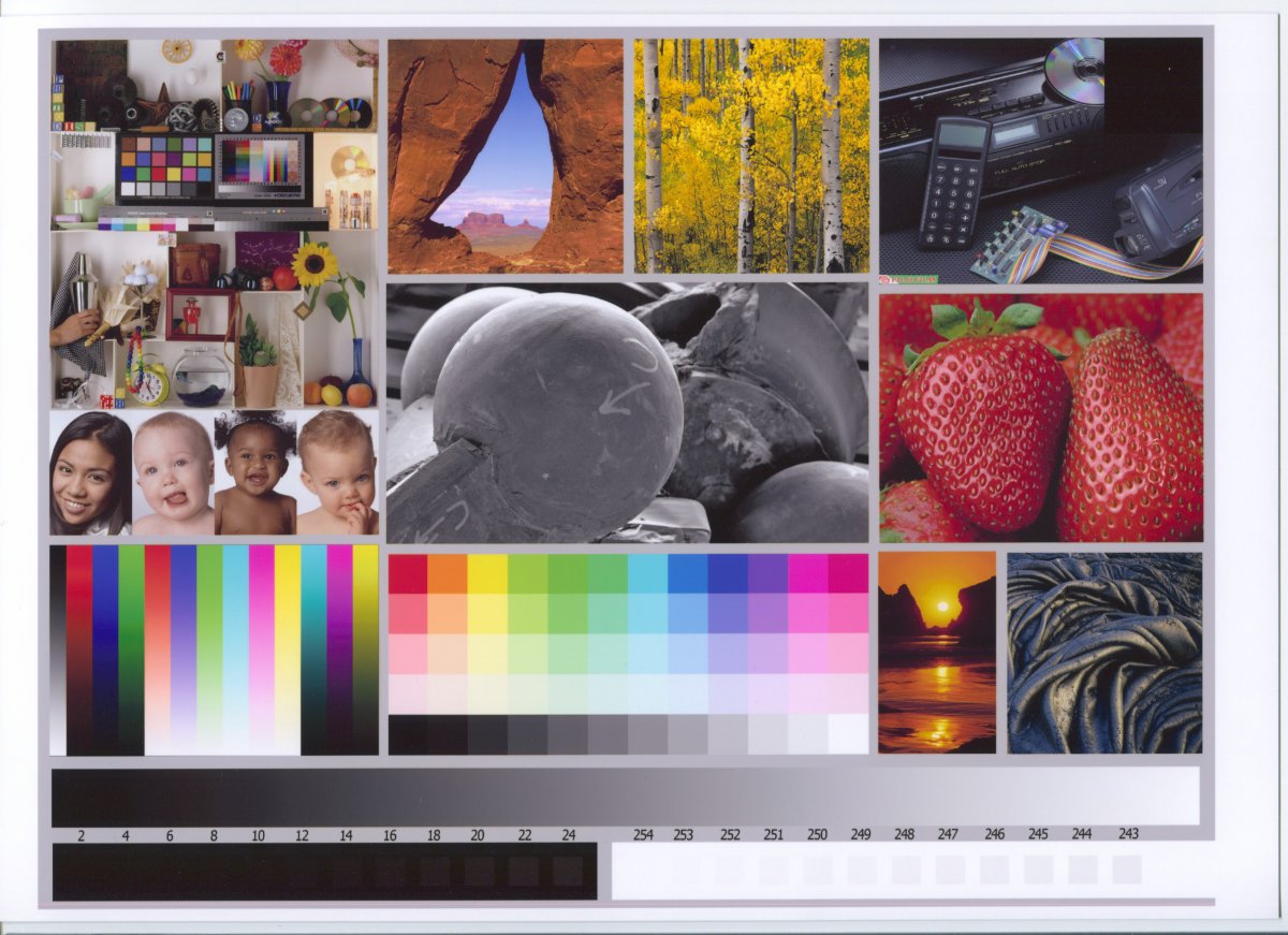

I have printed and scanned the images you suggested and added the circular quadrants as an extra. They all look excellent. It was a good illustration of the need to let the prints mature for 6 to 8 hours minimum. As they came off the printer parts looked distinctly off colour and off grey, however they progressively improved and are now quite remarkably good, see for yourself.
3,039
1,777
333
SC-900 ET-8550 WF-7840 TS705
View attachment 1199 View attachment 1201 View attachment 1200
Yes I too experienced some strange colour cast immediately after printing, but it went away after a time and It is perfectly neutral. So it does indeed live up "Wabi Sabi". Why I don't know...
