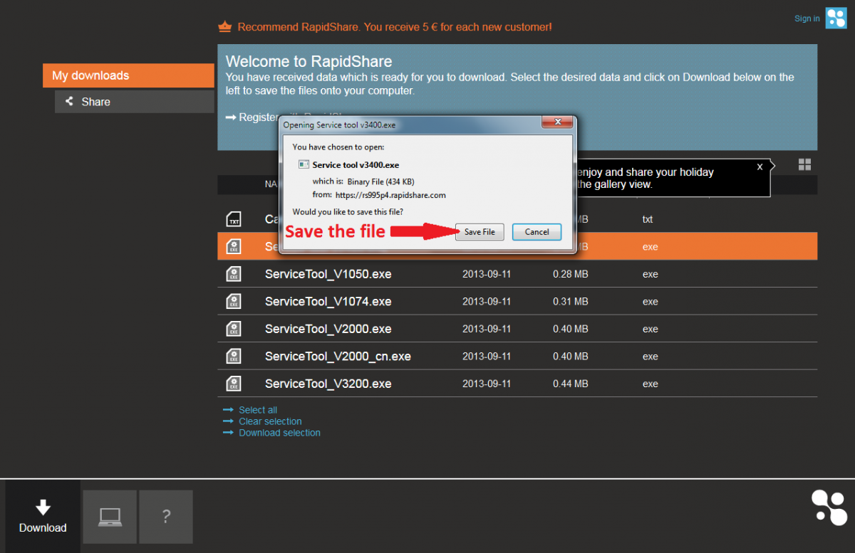

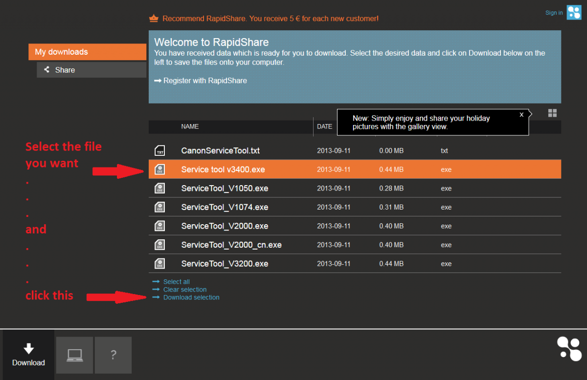

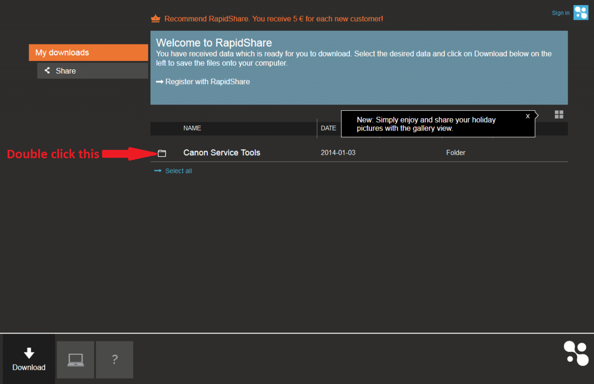

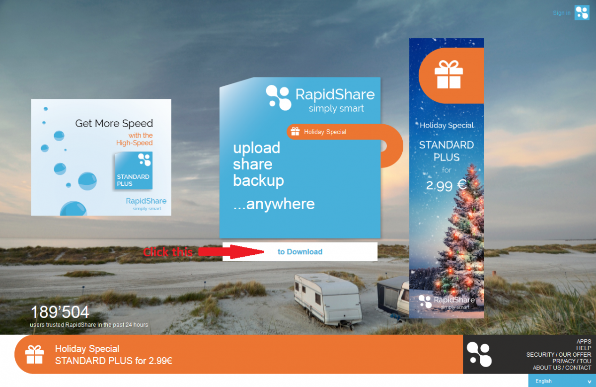

I had no problems downloading the four files from Tudor's link following the 4 image instruction. Note that you can only download one file at a time; if you select all, you cannot download. I guess you will have to join the site to have this convenience.

Just a blank rapidshare screen, perhaps it doesn't like XP.
5,250
5,155
I just powered up an old XP computer, and windows XP is not the culprit but the old version of IE, that is available for XP. The XP computer also has Firefox and Google Chrome installed, and there are no problems with download with these two browsers, but with IE I get an almost blank page with an error message.
Firefox is my favourite browser, so I recommend getting that.
