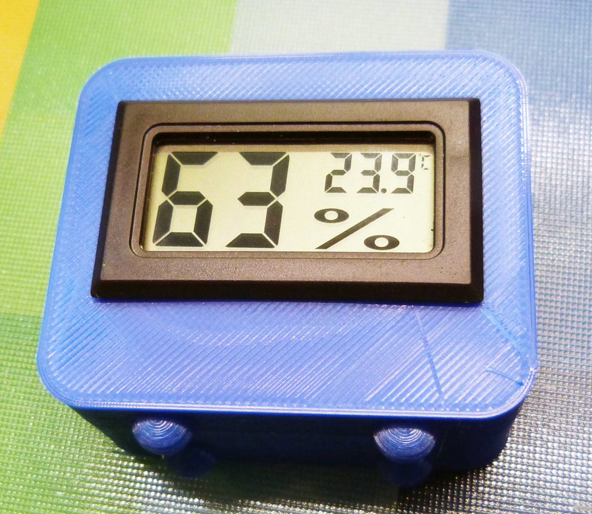

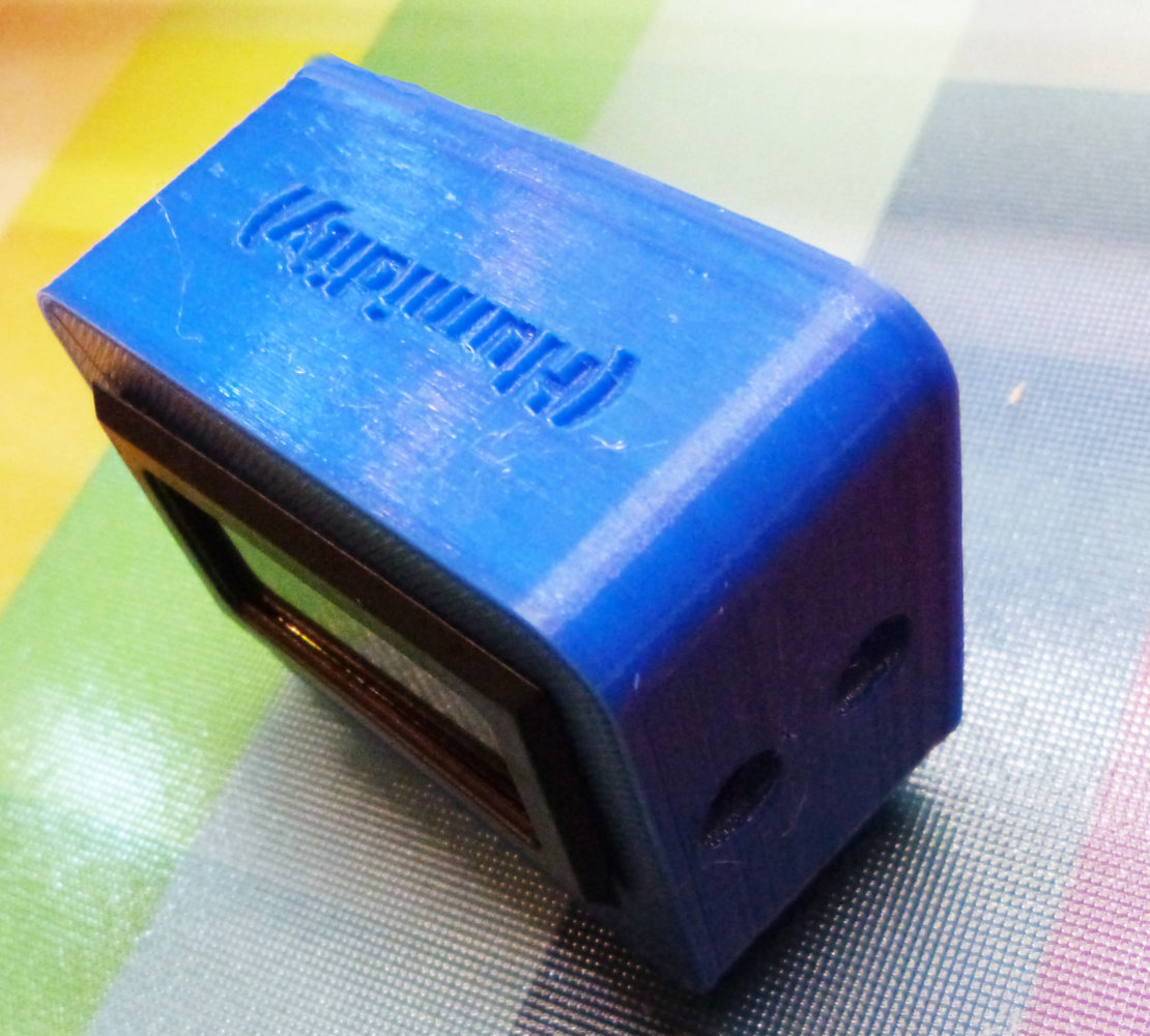

I have done some 10 prints using the PETG with no issues, and it seems to be as stable as PLA, but with different setting.
From what I can gather, the most important thing to have right is the print speed, all my work was done at half the speed I do PLA at, I tried speeding the printer up, and the quality went out the window, so I reduced the speed back down quickly and everything went back to normal.
So, if you want to give PETG a try, then watch your print speed, I reckon that the key to good looking quality prints, remember slow is better...
